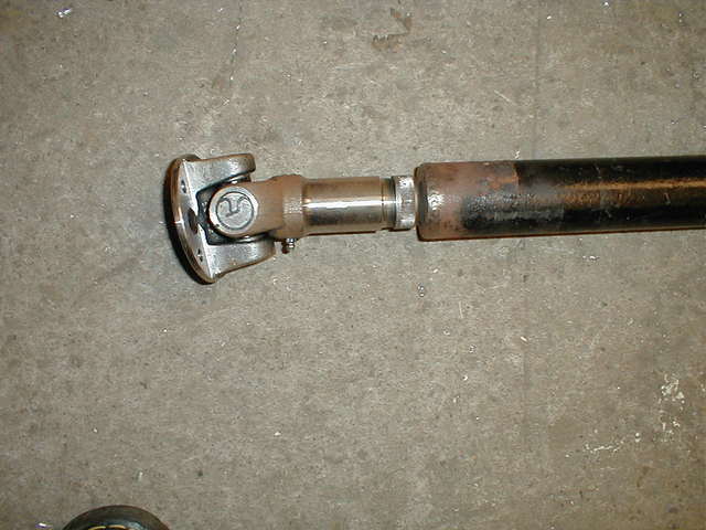

mangogrooveworkshop
| posted on 23/11/04 at 10:39 AM |
pics
mangogrooveworkshop
| posted on 23/11/04 at 10:40 AM |
pix

But what is the process in detail? You use a lathe to lop off the short end. It looks like the slider goes on the engine side. Is this correct?
Forgove this question: are sliders commonly found at propshaft builders?
This is not really a project I'm keen on tackling myself, so I need to know what to tell the machinist/prop welder.
Like I said, I'm having a terrible time with this. I would like to have specific instructions to tell the builders. Also, what speed should the
prop be balance?
