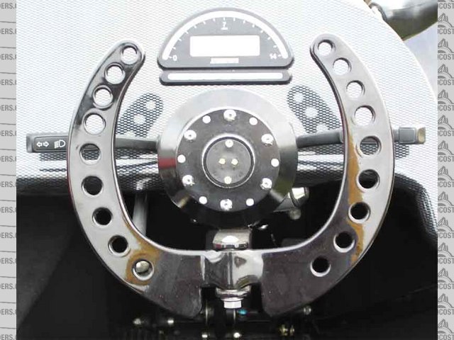

Here are a few photos of my paddle shift, excuse the dust. The original setup had all the controls on the dash, however I wanted to go to stalks to
make it easier to drive on the road (indicators a pain on a switch). The left hand stalk is indicators, high beam and flash. The right hand stalk is
dip beam, main beam and the end button changes to function of the display.
The paddles are a simple push pull rod system with bellcrank. The paddles have a short throw for quick changes and so they don't interfere with
stalks/ steering wheel.
I still need to make a cover for the back of the steering wheel boss, but that will be done over the winter sometime.

Robert Ryan
| posted on 25/11/07 at 11:07 PM |
Thanks for the pic's Looks a nice setup.
