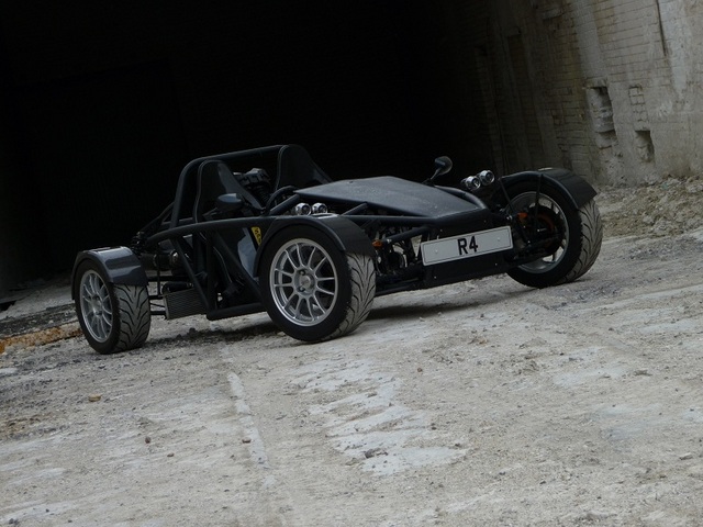

A few mock ups of front end shapes, it always almost looks better without it at all
FUORISERIE, you mentioned you would do the front a bit differently any suggestions?
ideas + drawings welcome!
ok, send me a few 3/4 front and rear view and a side wiew image, for my rough sketches.
I tend to agree with you, it does look better with the steel tubes showing...
I will try .....but the concept looks really good, will see what i can do for you.

That is a really “cool” buggy which you building. If I can do a suggestion for the front of the car. Perhaps its an idea to bend the top tube from the
nose round out of one tube, if you understand what I mean. It keeps the front of the car simple but smooth.
Greets Roy.

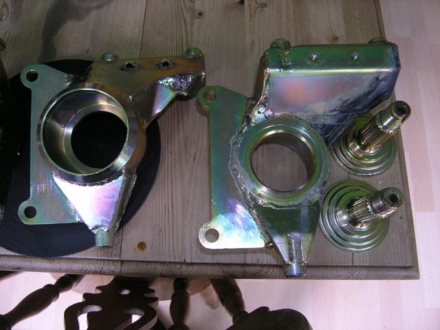

Remade the diff plates in ally, with an offset to allow a chassis tube between it and the engine. I also made up some temporary driveshafts from my
sierra ones to get the lengths right....

Just a pic from yesterday - roll bar and rear suspension is in
Damn fine work there my good man.
I bet you're itching to get out there for a blast aren't you?!
That looks
Originally posted by andyd
Damn fine work there my good man.![]()
I bet you're itching to get out there for a blast aren't you?!![]()
Awesome work Cloudy
The finished car will be something to be proud of.

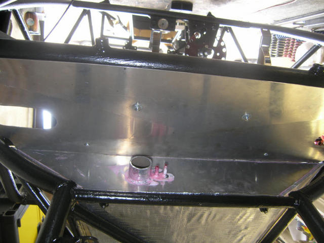

I've put the fuel tank behind the seats, but I've got two problems -
a) the proximity to the exhausts - is this something to be concerned about?
b) The seat belt lower mounts are directly under the engine raising up slightly, so the tank would have to move up about 2 inches from this position
(It can't - would have to have a tank made)
So my questions are, do I have a tank made to fit here, or make a bar to keep the belt mount down (I can't move mounts forward as there is no
strong structure) or do I move the tank into the space above the diff. The last options sounds easy - but will raise the CofG and move more weight
over the rear axle...
Personally I don't like the tank in it's current location....
If you had a bit more room, I'd suggest perhaps looking at an MGF tank but as it stands, I think above the diff is the best option...
*but* if you *do* want to keep it in that location, I'd have a talk to Bryn@alifabs about a custom tank ... I was pleasantly surprised at the
cost of mine...
I'd also think about some sort of heat shroud to go between the exhaust / engine and tank...
[Edited on 15/11/08 by stevebubs]
Another idea is to have two tanks, shaped to fill each side,with a 45 degree end to match the chassis, meaning it clears the exhausts better, and
doesn't interfere with the belts...

cloudy - 11/2/09 at 07:08 PMCustom tanks arrived and test fitted!
Made by Paul Talbot (U2U for contact details) recommended by russbost - £200
Internal anti surge pot tooabout 4.5 UK Gallons total....

jabbahutt - 8/5/09 at 07:17 AMany recent photos of the completely finished car? I've followed your build and it would be great to see some photos of the finished article plated up from different angles if you've got any.
cloudy - 8/5/09 at 07:54 AMI've been meaning to get a friend to take some on his DSLR, they are coming..
James
jabbahutt - 8/5/09 at 02:25 PMCheers looking forward to seeing them.

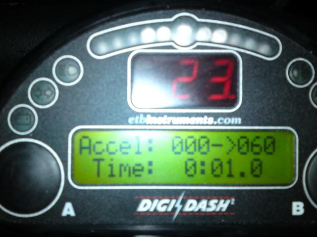

cloudy - 25/6/09 at 11:53 AMI'm working on a PIC based circuit to generate an adjustable ignition kill when I shift up using the kliktronic, to allow for full throttle up shifts.
Also I've programmed in a semi automatic option to allow it to shift up itself. It'll fire the kliktronic and cut the ignition at a set rpm sensed from the tacho![]()
Watch this space!

cloudy - 8/7/09 at 08:17 PMFinished my shift controller, currently giving me adjustable ignition cut for flat shifting, and I've also designed in a tacho/shift light input and upshift output for auto upshifting which I'll wire in later

cloudy - 21/10/09 at 10:48 PMmnn yes it seems to work
70mph in 1st anybody?
James

cloudy - 13/5/10 at 08:37 AMIan from Complete Kit Car took some photo's of the car yesterday at a local lime kiln, look out for it in the June and July issues

mrxmn - 4/1/11 at 02:59 PMJames that looks awesome on the track though maybe not the best time of year. At least it was dry. Would be wicked to do a track day in the summer with the r4 and the MK Indy. Maybe rockingham?
Mark (SJ's brother)

cloudy - 24/1/11 at 09:36 AMGood to see you back! Liking the new track car
Weather almost good enough to start taking the R4 to work again, can't wait - poor things only been out a few times since last summer!
