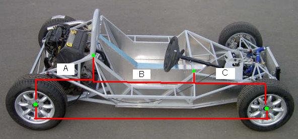

By chance, is there a good chap able to take some measurements on a genuine J15 chassis for me? I'd like to start preparing myself for when the
body will be here.
Or maybe I am very lucky and my Riot is not longer than a J15. I can't really evaluate the difference from all the pics I found online.
Here is a basic drawing:
I'd need A, B and C , which once summated, will result in wheelbase.
Thank you

Unfortunately my car is almost finished and the centre tub is bolted down. See: http://sylvabuild.blogspot.co.uk/
I have however measeured the following:
1) Centre of wheel to start of central tub: 510mm
2) The roll bar in my case is 45mm in diameter and fully occupies the first part of the tub as it rolls round the rear of the seats.
3) The length of the tub at the top surface from the engine opening edge to the bonnet closure point =1110mm
The Closure point to centre of front wheel is 650mm
The distance between the front of the tub and the top chassis rail is about 100mm but I could not measure that at present. It could be done if it
helps but is very aukward just now..
  Tub to chassis front
If I can help in any other way do not hesitate to ask.

So, with your measurements, the wheelbase of the car (A +B +C) is about 510 + 45 + 1110 + 65 = 2315mm?
theprisioner
| posted on 3/3/13 at 05:07 PM |
I make it 2270 as roll bar is part of second measurement.

I have an outline sketch of the Riot chassis from JP. It shows standard wheelbase as 2,260 mm and the LWB version at 2,320 mm. The standard version
agrees with my J15 at 2,260 mm with no need to lengthen the bodywork.
Hope that helps.

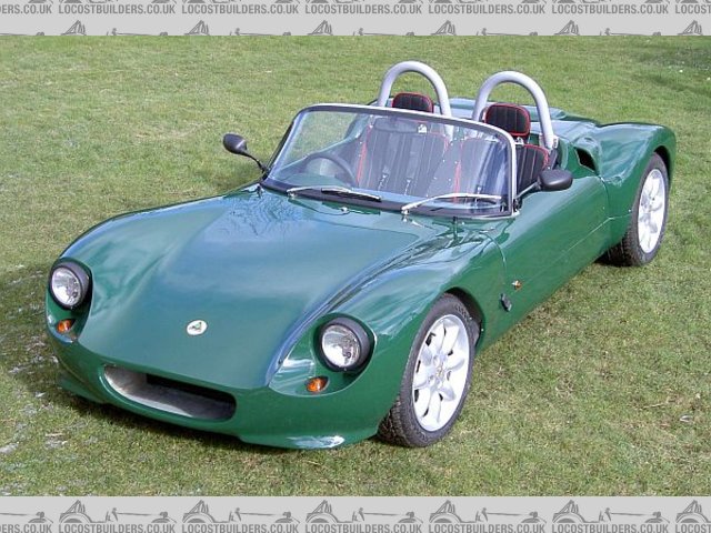

inkafone
| posted on 14/3/13 at 11:35 PM |
Pic from totalkitcar site
I think this is still an attractive car and it looks like some small doors could be cut out. Don't like the twin roll bars though.
