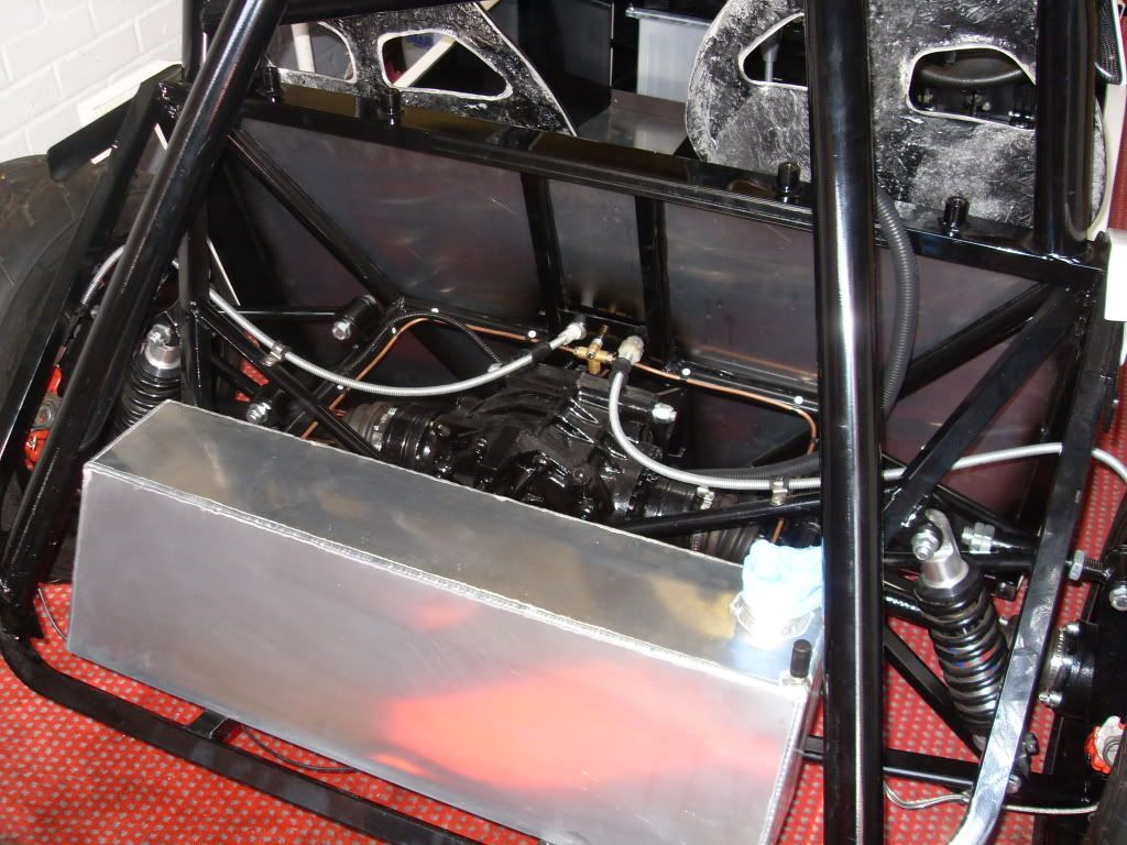

Do i need straps over my fuel tank for the IVA? Has anyone failed for not having them? Has anyone passed without them? At the moment it's tiger sealed down and will not move anywhere, MK told me to do it this way and that there is no need to fit staps. Here is what it is like but i have now fitted the rear panel, arches and all the electrics so it will be a real pain to have to take it all off again to fit straps.

I don't know what IVA needs but personally I wouldn't be comfortable sitting in front of say 20-30Kg of fuel and tank that's only glued to the chassis rails. I'm thinking here about what might happen in a frontal impact. I say fit straps.

I'd put some on as said above. There's a fail listed here for no tank straps posted just last night just yesterday.

And its fixed to the power coat NOT to the chassis and the powder coat can come off i would fit straps
I would not pass it at IVA

At least the tank could slide towards the front of the car in the event of a rear end shunt! There is no protection at all for the tank on that chassis ! Not sure what the regs are as regards to IVA but would have thought at least some protection for the tank would be needed??

No doubt glue can be strong enough (Lotus Elise chassis is glued together).
But it is near impossible to non-destructively prove that your glued joint is strong enough. Especially as Tigerseal softens if exposed to fuel.
My guess is that you should add some form of mechanical fixing.

I'd fit straps for piece of mind, once fuel gets on the tigerseal it will work it's way loose
i ended up beefing up my straps to studding, as on the track it wasn't enough just to have weak ally straps holding it

Yep, it was me that failed on this (we also took MK's sugestion!) and it might be a pain to do now but is possible to do with leaving the rear panel etc in place if you can get the car up in the air to work on.

Using straps rather than PU also makes it a lot easier to remove the tank should you ever need to.
Should be easy enough to make from steel or ally strip (B&Q sell a variety). If using steel make sure you use something between them and the tank to prevent corosion. Be carefull with ally as it can break where you bend it; I had a Striker loose its (full) fuel tank infront of me on track when the ally straps broke and it fell out! A 6.5gal tank bouncing along spewing fuel in a braking zone from 100+mph was interesting to say the least... Maybe PU would have been better afterall...
An earth strap between the tank and chassis is an IVA requirement on metalic tanks. There's been a few failures for that recently.

FYI - I had decent steel straps ( with rubber linings ) but it was a fail point at IVA because I had forgotten to use self-locking nuts strap / chassis.
