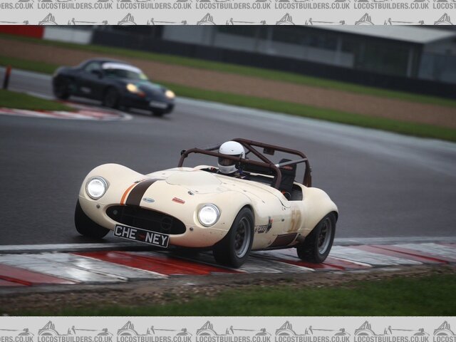

This might be a silly question, but I assume your 'practical adjustments' were reversed after IVA?

posted on 10/2/26 at 08:59 AM Reply With Quote
Donington last week:
Doni2026
Doni2026
Sanzomat
posted on 10/2/26 at 10:08 AM Reply With Quote
Brave on the wet kerbs!
TimC
posted on 10/2/26 at 10:27 AM Reply With Quote
No more slippery than the rest of the ice rink.
