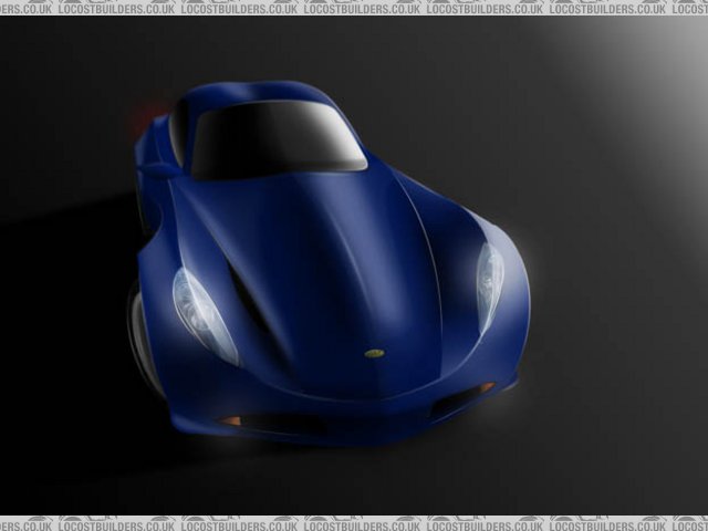

here is a rough thumbnail sketch of a possible front.

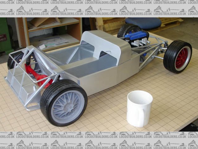

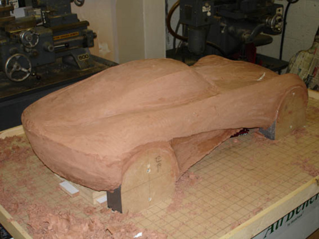

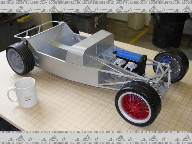

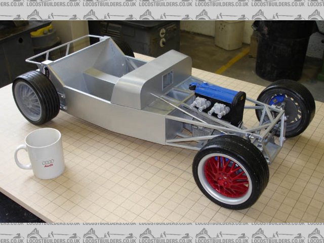

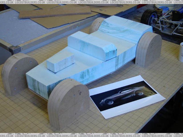

made the Clay Buck this morning, soon be ready to sculpt the body
So THAT'S how it's done!
I wondered how you sculpt a body and be certain that it would fit over everything.
When the clay is hard can the foam be removed and the body then sat on the chassis?
Paul G

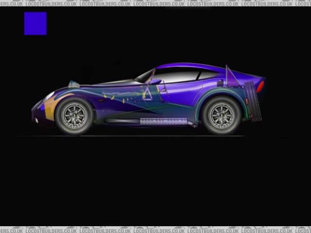

so what do you all think of the revised rear end. all comments welcome.
gaz
Looks stunning imo
It does look interesting!
Just a thought - how much headroom do you anticipate? Have you tried fitting a "standard human" inside on the drawing board?
Not trying to be negative, honest! Just that it's better to address these issues early on in the design.

hi Dave, if i have measured things right it should be ok, however i have considered building two very subtle domes over the heads of the occupants. I
think it would give the feel of a small agile car shrunk around the driver. The last thing i want is the vehicle to become too large. I hope to have
some other views and the roof issues sorted out over the weekend.
Can't wait to start the Clay model.
cheers, Gaz

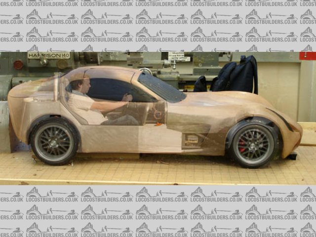

I hope this image gives an idea of the size of the vehicle.
keep the comments comming
Thanks Gaz
I think that it's very comely! I wonder if that scalloped side panel might not be very aerodynamic both in terms of lift and drag.

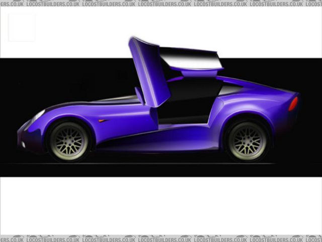

How about this as an idea for the doors and roof, Similar to razman's.
I think that i will get a better idea of door openings etc once the model is in clay and i can have a good look around it.

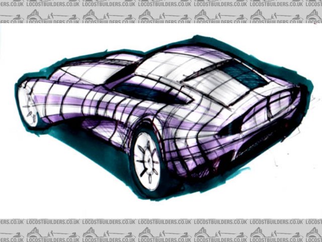

Here is (and i stress) a very rough rear view

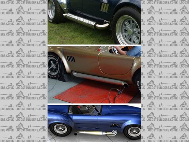

Just a thought on the exhaust. (Well I would, wouldn't I)
Is the bottom of the scalloped side the edge of the Locost chassis?
If so, I can see a "Cobra style" exhaust tube/can in there.
Tee He, I'll start making the prototype.
atb
Paul G

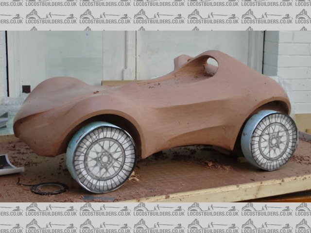

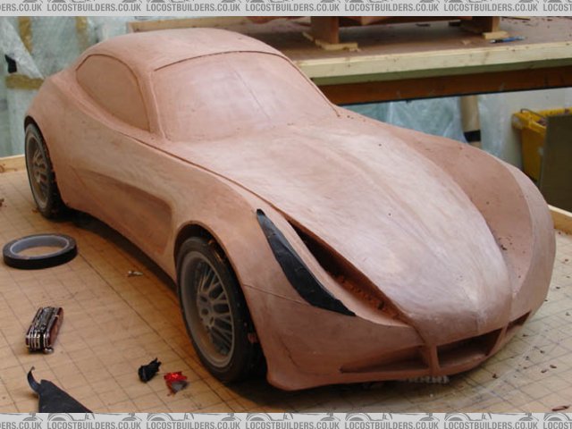

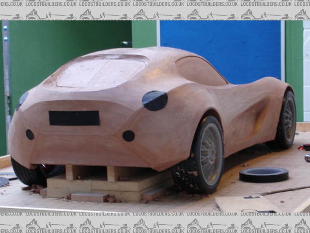

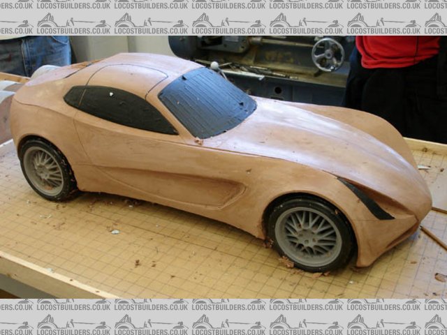

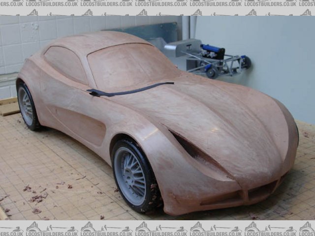

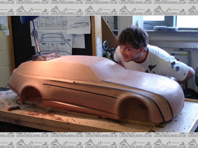

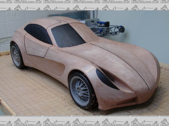

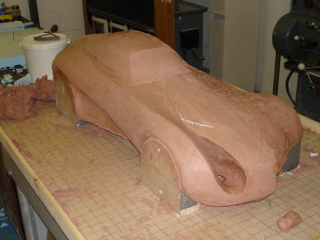

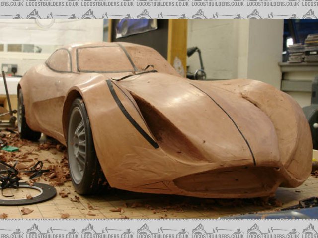

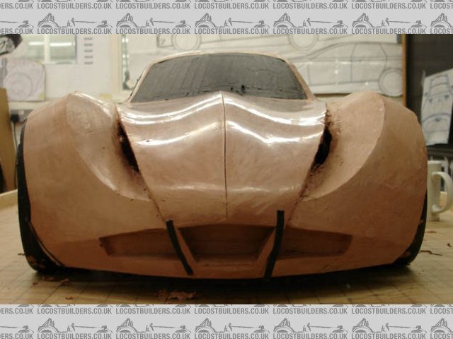

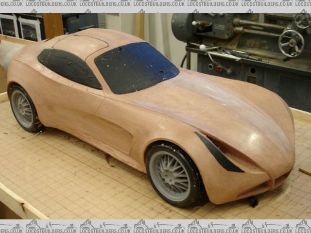

gonna start the clay model today.
if anyone is interested the clay model of my design is underway. I have only spent a couple of days on it so far, i hope that in a few weeks it will
be fairly resolved.
if anyone has any questions or opinions please let me know

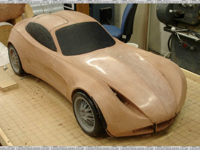

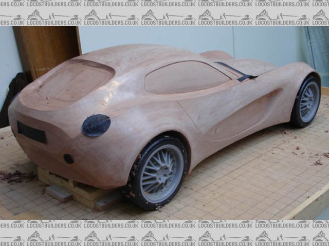

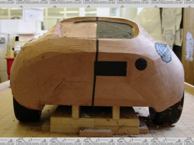

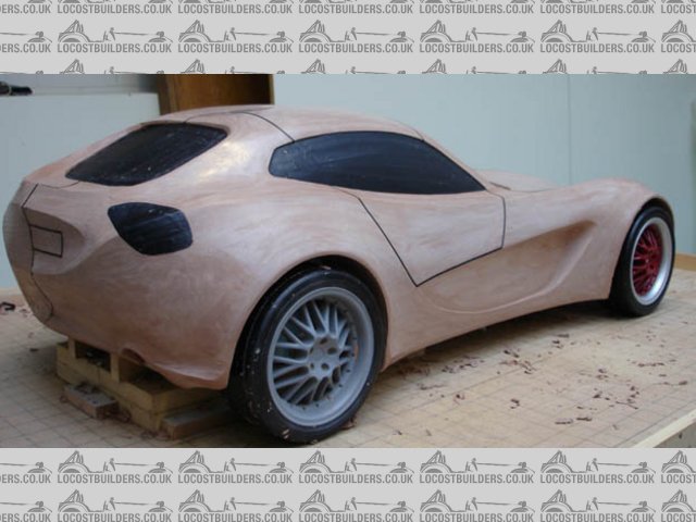

and the rear
Kin hell thats looking great.
Your definitely onto something. It's a very dynamic shape that looks like it's going fast just sitting still. Have you modeled the sight
lines from the interior yet? (Cad).
I really, REALLY hope that you don't stop at the clay stage because I think it's awesome.
thanks for the comments mate.
I havent sorted out the line of site yet. I know that the bonnet needs to be lowered a bit and i hope to get it sorted over the next couple of days.
Once the body is a little closer to the final design i will be able to measure from the model and still have chance to change things around. (the joy
of clay)
I havent done any cad work on this project yet and i am not sure that i will have time to as the university deadline is fairly tight.
Tomorow i really need to work on the rear arches because at the moment they look shite (technical term)
thanks for the comments and keep looking on here because i will try and update it every day or so.

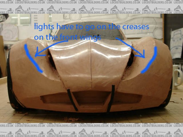

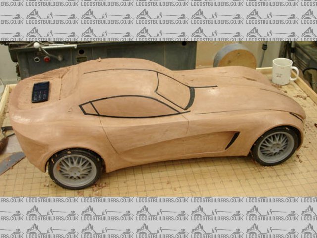

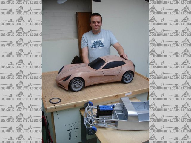

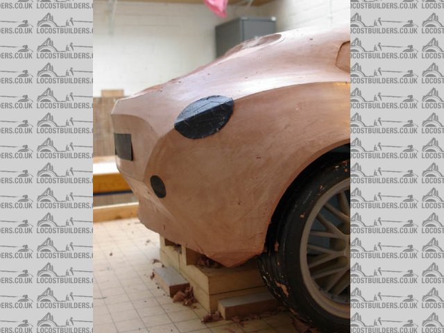

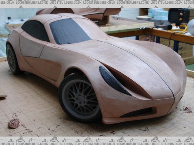

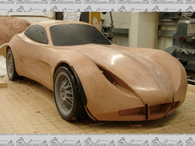

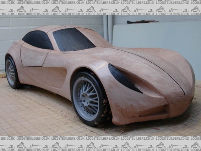

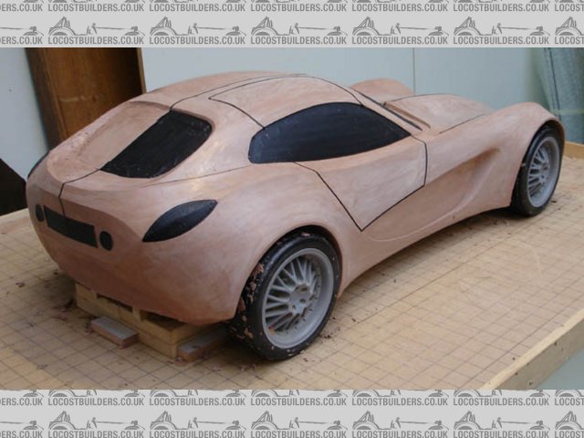

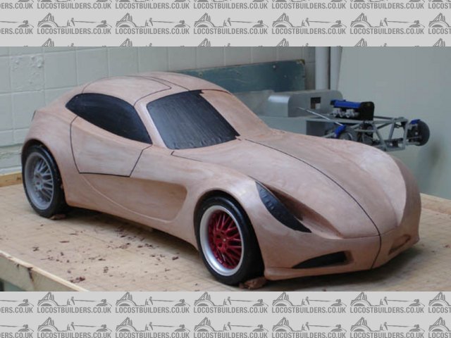

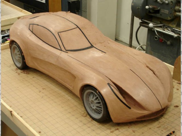

well this is where it is at today.
If i could find a company that would be willing to work with me on this and build it full size i will make you a soft top,
and from the side.
thanks again for all the comments.
give it another month and i hope it will start to look a bit tasty.

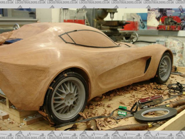

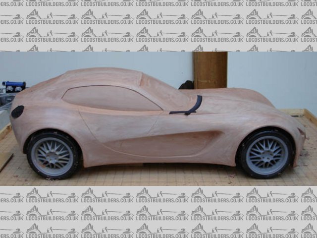

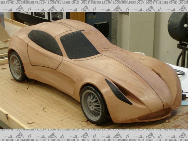

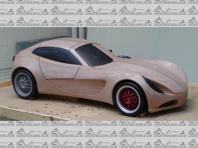

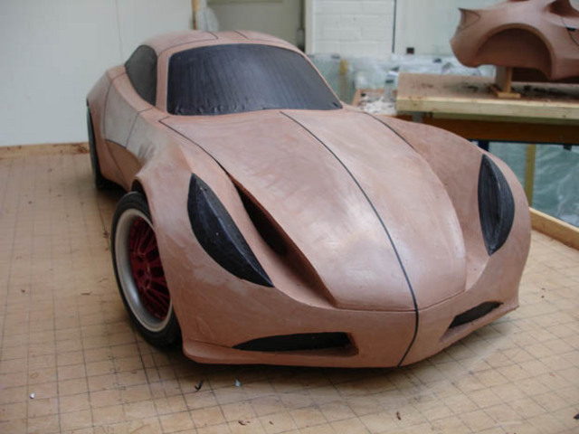

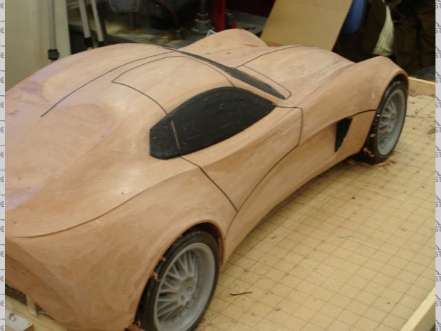

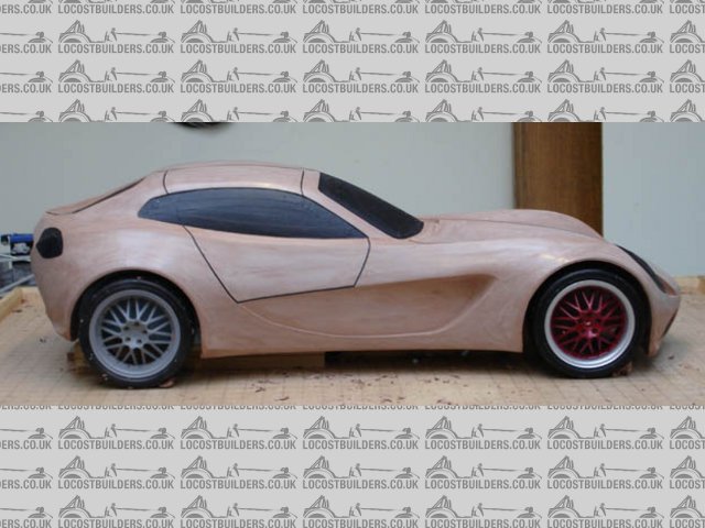

after using clay over the last few days i have come to the decision that it is the perfect way to make air intakes, even mirrors and nose cones.
Hi Gaz,
Looks good, just make sure your effort is not lost.If you digitized the shape you could make a buck using the same method as:
http://www.locostbuilders.co.uk/viewthread.php?tid=43112
Even if you don't do it now it will be worth keeping the model!

with some more work
bat
[Edited on 13/2/07 by timf]
when the thing is finally finished there is no way i would throw the model away. God knows where i will keep it though.
when i am not at uni i live near Sudbury on the essex/suffolk border. Why?
As for the Batman thing, I don't think it would pass SVA with all the pointy bits!

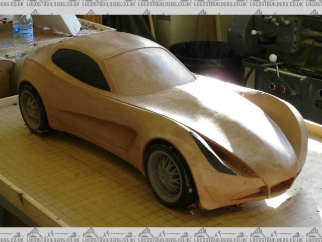

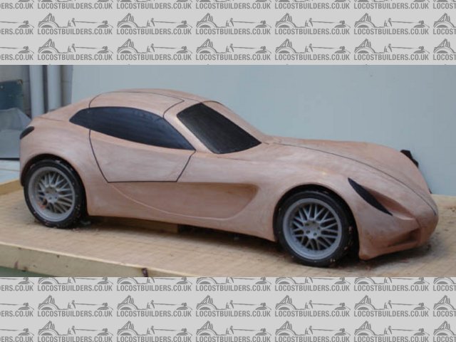

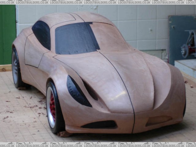

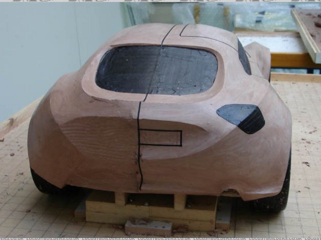

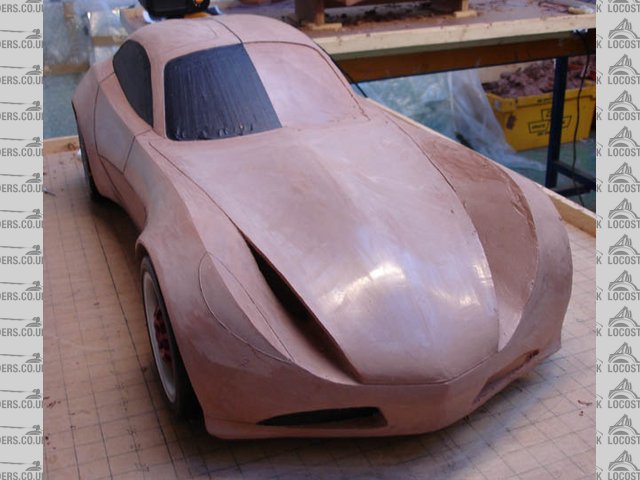

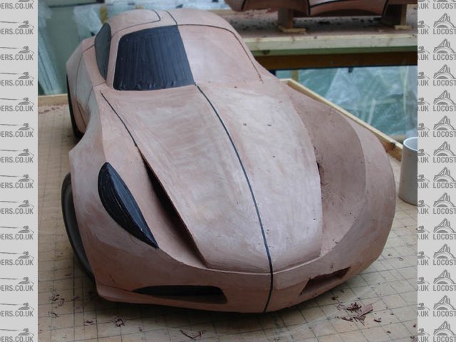

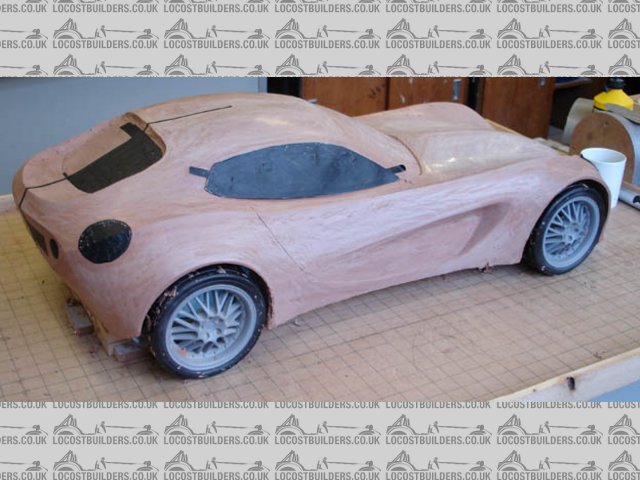

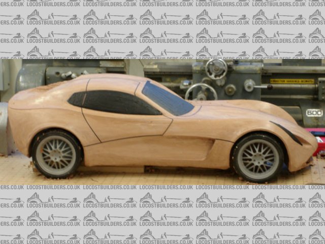

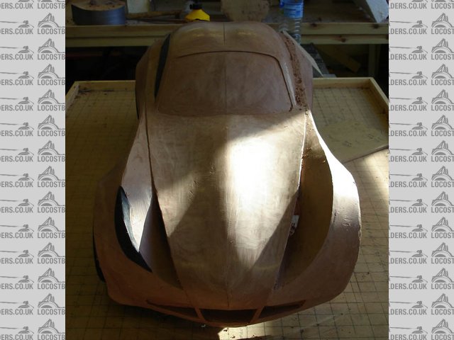

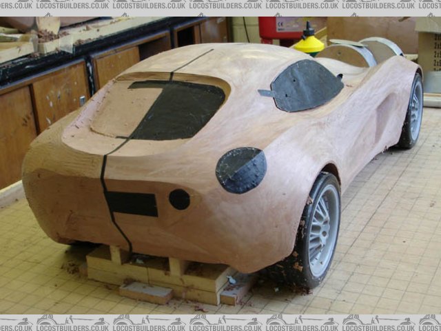

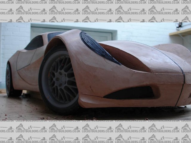

here we go with the latest progress
comments please.
That does look great. I have a question though - any idea of the aero effect of the "channel" behind the front wheel? It appears that just at the point where most road dirt (and therefore presumably some air) is thrown up from the wheel there is a scoop along the car - would this affect the aerodynamics at all?
to be honnest, i am not sure but i don't think it we be a problem as it will be removing trapped air from the engine bay.
It must create less lift then clamshell mudguards?
some people say it is a problem, some say its not.
I have herd rumours that there is a small wind tunnel in the engineering department of the uni. So there must be someone there who can give me an
answer. I will try and track someone down to have a look over the model over the next week.
thanks for the comment, i hope we will have an answer soon.
Thanks.
GAZ
I'll make a couple of observations -
1) I'm a bit worried about the height of the scuttle & over the front wings (driver's view)
2) the curved 'hole' between front wings & bonnet looks like it would be tough to mould in GRP
3) the waisted in 'side pod' area is a really strong styling feature - sure the aero might not be optimal, but lets face it, it's never
gonna be!! It looks like it's been diluted on the clay model compared to some of the drawings..
The height thing is the main worry for me, i'm quite tall & have a cushioned seat in my locost but am very aware of how low I'm sitting
in the 7 - most folks' eyes will be lower still
Still way cool though!
Bob
[Edited on 15/2/07 by Bob C]
Let me start off by saying that I quite like it. It's unusual in that it has an overriding retro style with an edgy, modern feel to it. It would
be hard to make of list of all the things I like because I do like it, so forgive me if I just point out a few petty things that bother me slightly? I
know you won't mind....
The rear wheel feels wimpy and I don't know if it's the arch or the bulk of the paneling above the arch. Maybe it needs a beefier tire?
Bob's comment about the front vent is good, but it doesn't mean that it's not insurmountable. It just means that the mould making
process is going to get very 'expensive'. FYI I debated some of those internal mould components during my build and decided against them due
to cost/complexity issues.
You need to start thinking about glass now, before you finish the clay model. Otherwise you are looking at a project that will be priced out of the
range of anyone remotely interested in the car.
my .03 american cents...
hi guys,
I will try and answer some questions.
first bob.
the scuttle is the same height as a book chassis and the top of the roof is the same height as a roll bar, I am sure that there is enough space to fit
a seat with rails and height adjustment. (well i hope so)
Oh by the way the height of the roof is 44 inches at the mo.
When i started the clay i built up a MDF and blue foam buck with the same exturnal dimentions as a book chassis. With probes and reference to my
scale chassis i am able to judge where key componants are under the clay, for example i know that there is 70mm clearance over the top of the engine
block.
The molding of the front could be broken into seperate parts, if a seperate bonnet was used i could achive the effects of the air intakes.
thanks Bob and keep em comming.
Time for Sgraber.
You are completely right about the rear wings and i will do a few changes. I still have some serious mods to do on the rear in the next couple of days
so keep looking and commenting,
The glass is a bit of an issue at the moment, not sure what road to go down. I was thinking plastic rear and side and a cut down glass screen for the
front.
There is a bit of politics at the Uni at the moment. (different lecturers saying different things) so if anyone has a good answer for the glass issue
i can use it as backup.
Thanks again Guys.
Gaz.

thanks Rob.
I like the idea of vents in the top of the arches, that could help with some issues i have with the bonnet styling, I will mock it up and put it on
here.
It wont be today as i have the wonderful task of sitting in the house and waiting for a delivery. BUGGER.
The scallops will have two main and competing effects:
1/ Assisting the escape of the air which would otherwise build up in the wheelarch (louvres on the upper surface of the arch/fender would also help,
but they have unpopular practical and styling consequences). This will reduce lift.
2/ They will allow some spillage of flow from the side of the car into the underfloor area. This will increase the pressure there and not help the
lift situation (though not generate any additional lift in itself, just reduce the benefit of the low pressure under there). If you are thinking of
having any sort of rear diffuser then you might consider putting some sort of 'running board' along the side to effectively extend the plane
of the floor of the car out to the full width of the body.
This may not be the way it works, the scallops could create rolling vortices that actually block the flow of air out of the engine bay, but create an
air skirt down the side of the car aiding downforce if a venturi is used. They may also add a large drag factor.
Is the windscreen based an a production unit?
Have you done a mock up of driving position and eye line, as it looks as if eye line is in line with top of windscreen.
Screen pillar is a problem and will produce a blind spot.
As for testing aero properties, fit wool tufts to model,strap it on the roof fo a car and film/ photograph it. (natures wind tunnel)
Looks good in a traditional way.
some images fro the weekend.
raised rear arch
filled side
bottom edge taken out wider
as far as the eyeline is concerned i think it is ok. the seats sit lower in the car then you might think.
Imagine the high point of the roof being the top of a roll bar. the view should be no different then a normal locost.
thanks
GAZ
If the outboard edge of the sill is sharp then you will get vortices rolling up along that edge regardless of it's lateral position. With the
front of the sill angled inwards, as part of the scallop, it is quite possible that the low pressure at the core of the vortices would act on the
underside of the car and enhance downforce - very much like an inverted delta wing.
I 'm not sure how that vortex formation would block flow out of the wheelarch though - isn't it too low and further inboard?. Can you give
a bit more detail?
[Edited on 16/2/07 by Rob Palin]
The top of the front screen can always be raised or moved futher into the roof, if you know what i meen.
the screen will be a simple shape (a gradual curve in both directions so i imagine it to be cut from an existing screen.
thanks again for all the help.
GAZ
Hmm, not ugly but I'd do a few changes
1) windscreen min 1/4 longer
2) Reduce front pillar thickness, a lot
3) Include a Diablo cutout to the lower front door window line to improve visibility.
4) Make the bonnet more pointed, looks like a big tongue in the last pic.
5) In one of the drawings the rear area was much smaller and lighter, that I liked a lot the model looks very fat from behind
6) Front lights look to hidden for the SVA, I was wondering where they even were till I saw the front view.
7) The doors are going to be very thick, doubt they will hinge out, gullwings might end up very heavy with such a large lower door. Maclaren butterfly
hinges might be the solution.
Oh and I love the sculptured roof, very classy.
Understand I'm not trying to be negative in any way; you're doing very well. Just a few observations based on my personal tastes...
ok before I get accused of just criticizing here's my suggestion of how the front might look, bairing in mind I've only got ms paintbox on
my work machine.
[Edited on 16/2/07 by macnab]
I think you could raise the roofline slightly and thereby extend the windscreen/sidewindows a bit without detracting from the shape.
Brian
Ps The typical, only a quickie in paint/refinement required disclaimer applies
[img][/img]
http://www.thekitcarworkshop.co.uk/page31.html
Yeah...Martin was struggling to find the business justification. Even more so now, I should imagine.
If it was 1/4 longer it would be below the steering wheel and through the scuttle, so this is not physically possible.
It does need to be thinner but it will be made of fibreglass and it needs to be strong.
A Diablo is flat sided, this is not so it wouldn't work.
This is going to be changed anyway, I have never been happy with it.
I have just filled the whole of the back in to start again as I was not happy with it.
The Aero 8 gets away with it! But again these will probably change.
7) The doors are going to be very thick, doubt they will hinge out, gullwings might end up very heavy with such a large lower door. Maclaren butterfly hinges might be the solution.
The doors are explained better earlier in this thread, with pictures.
Thanks for the comments.
Gaz 1977 - 16/2/07 at 07:10 PMquote:
Brian
Image deleted by owner
Thanks for the image, the height of the model is quite deceptive in the photographs. Just to check it out I've just been in the garage and sat in my Dad's (907) locost and the top of the roof is the same height as his roll bar which gives a clear four inches over my head. That's with Cobra seats mounted two inches from the floor and I'm six foot tall. I'm going to mock up a roofline for a photo tomorrow.
Please keep the comments coming.
Thanks a lot,
Gaz
Uphill Racer - 16/2/07 at 07:35 PMSorry Rob,
I 'm not sure how that vortex formation would block flow out of the wheelarch though - isn't it too low and further inboard?. Can you give a bit more detail?
My mistake, thought engine bay was exhausted from bottom of scallop behind wheel arch.

Gaz 1977 - 17/2/07 at 02:17 PMwe have had a play in the garage and mocked the roof line the same height as the model but with the front a little heigher. 44 inches at the back and 42 at the front
Gaz 1977 - 17/2/07 at 02:18 PMand from the front.
Gaz 1977 - 17/2/07 at 02:20 PMand from the head rest.
the scuttle on the car in the pic is the same height on my model.
thanks for the help
Gaz.![]()
escort_innit - 17/2/07 at 02:59 PMIf those are the headlights marked on in black tape I'm not sure I like them, the two very similar shapes look too fussy. Perhaps you could arrange the lightclusters around the airvents?
I did a couple of sketches to show what I mean;
escort_innit - 17/2/07 at 03:00 PMOr this;
Gaz 1977 - 17/2/07 at 06:13 PMnice idea
Gaz 1977 - 17/2/07 at 07:54 PMI have just read my last reply and it looks like it could be misinterpreted as taking the piss, so sorry for that, I do really like the idea of the lights where you have put them and i will definitely try them on the model.
thanks for everyone's responses
Gaz
escort_innit - 18/2/07 at 09:46 AMI didn't take it as offensive, but apology accepted anyway!
chrisg - 19/2/07 at 02:50 PMI've been thinking Gaz (dangerous I know) but because of the need to retain the high sill (side) of a Locost wouldn't a pop canopy like the Nova work?
No messing with butterfly doors or gull wings, simple and easy.
Just a thought.
Chris![]()
Apparently Uroglass do the screens too!
[Edited on 19/2/07 by chrisg]
Fred W B - 19/2/07 at 05:36 PMBut, how do you get out of the car if it happens to be upside down?
Fred W B
Gaz 1977 - 19/2/07 at 06:32 PMhi chaps.
To answer fred, A door in the floor. (your last name isn't Flintstone is it)
The nova roof could be a bloody good idea.
I still fancy a removable hard top so what if the front screen stayed in place and the rest moved up and backwards?
On the screen front, i had a look at a smart roadster in a car park and it might well nearly fit. I know a guy a uni with one so i will give it a measure in the week.
the rear screen is not so much of a problem but how about using the new vauxhall tigra?
I will .be back working on the model tomorow and i will se if i can come up with a front end.
Thanks.
Gaz
Gaz 1977 - 20/2/07 at 06:22 PMhere are the latest images,
Gaz 1977 - 20/2/07 at 06:23 PMand another
Gaz 1977 - 20/2/07 at 06:26 PMand one more.
all comments would be greatfully recieved
thanks
GAZ![]()
Tralfaz - 20/2/07 at 10:15 PM
macnab - 21/2/07 at 12:30 PM10/10, well done
gottabedone - 21/2/07 at 04:54 PMGaz
Very nice work. Your initial designs were very nice but progressive works seem to water down what you initially intended. We all have our own views on design which are influienced by our favourite cars. Other peoples views are steering your design towards TVR/Marcos/Melling etc.
Your idea for the sculpted sides has raised many a readers eyebrows. There has been a lot of chat about aero dynamics but how efficient a shape is the 7 - not at all. The sides are one of the main features of your first drawings and IMO helped to lessen the impression of the height of the car.
Your design is wicked and I think that you should model the car the way you intended - with a few modifications of course.![]()
keep up the good work - does this pikky (hope it works!!) of the saab aero x get you thinking about your roof????![]()
regards
gottabedone - 21/2/07 at 04:59 PMI've put the image of the saab in my photo archive
regards
David Jenkins - 21/2/07 at 05:07 PMGaz,
I agree with Steve - don't lose sight of your original concept as it had many original ideas. There is a danger that your design will get watered down as time goes on and you get more and more diverse opinions.
Remember - a camel is a horse designed by a committee!
It does look good though...![]()
cheers,
907 - 21/2/07 at 08:51 PMHi Gaz.
It's looking good.
Love the shape of the front corner. The bumper blending up to the nose makes the
air intake hole look a different shape from the side than from the front. Cool.
Have you toned down the front edge of the side scallop?
That's a unique feature. I'd keep it sharp. (IMHO of course)
The light position looks a lot better too.
Paul G
Gaz 1977 - 21/2/07 at 09:29 PMThanks for thr pics of the SAAB steve I like that ALOT.
Point taken on the side, I need to try the skoop again in a different way.
I will get there in the end.
Two weeks in, three months to go.
thanks for the comments.
Keep them comming.

Gaz 1977 - 22/2/07 at 07:04 PMhere are the latest
Gaz 1977 - 22/2/07 at 07:06 PMand the side.
the car phone is a bit big.
Gaz 1977 - 22/2/07 at 07:06 PMand another
Gaz 1977 - 22/2/07 at 07:09 PMand finally the rear.
as usual its all work in progress so all comments would be great
GAZ![]()
chrisg - 22/2/07 at 07:12 PMLooking good mate.
You know we're all sitting here waiting for you to post every night don't you?
I like the widow treatment but I'd lose the built in calculator!
Chris

macnab - 23/2/07 at 01:10 PMYou know from this angle I can't fault a single thing, its just spot on.
Will this shell be put into production? As I would be interested in getting one for my indi, what’s the intended wheelbase and track?
This is a fascinating thing to watch![]()
The thing I like is that it's really a very low and small car, would look stuning in real life.
[Edited on 23/2/07 by macnab]

Gaz 1977 - 23/2/07 at 06:07 PMThanks for the comments once again.
I have done a little work on the front end today but forgot to take my camara to the workshop. (BUGGER)
As for the wheelbase and track it is the same as the Haynes book chassis. (old book sorry Chris) I have left the book at uni and I cant remember off hand. (AGAIN BUGGER)
It would be nice once the design is finished to see it full size. If I could find an interested company i would be a very happy man.
Anyway I thought i might post some pics of the chassis.
Thanks to everyone
GAZ.![]()
Gaz 1977 - 23/2/07 at 06:09 PMand the back
Gaz 1977 - 23/2/07 at 07:09 PMJust a thought would it be possible to run the exhaust up the transmission tunnel?
GAZ
JoelP - 25/2/07 at 12:47 AMmight cause issues with any wiring or fuel pipes in the tunnel, though these could be relocated if required.
Would need insulating though id guess.
907 - 25/2/07 at 07:51 AMquote:
GAZ
Hi Gaz.
As well as the issues that JoelP has raised there's also the issue of the need for space for the suspension travel on a solid axled car.
The rear end of the prop could well have 50 / 75mm of up & down movement.
I know you will not be keen on the idea of an external exhaust as it will detract from the shape of the body
but a Cobra style can might be the only answer for a book chassis. Some of the plain 3" pipe ones look quite good IMHO.
Googled images below.
Atb
Paul G
aka Dad
Gaz 1977 - 25/2/07 at 09:18 AMIts just a thought really.
If i run it under the car i will have issues with ride height. The tunnel on my chassis is open underneith which would aid cooling.
I could run it under the fibreglass sill but once again there are problems with cooling.
I can have side pipes but if i can avoid it i think i will, I dont think they will work with the design, Thanks for the pics though
Or I could have short pipes that exit through the vents behind the front wheels.
I am open to sugestions
Thanks chaps.
Oh I went to the SMART garage today and measured the Roadster's front screen, and I think it will fit, i might even be able to use the wipers.
Thanks again
GAZ

Gaz 1977 - 26/2/07 at 06:34 PMwell here are the latest pics
Gaz 1977 - 26/2/07 at 06:34 PMand the side
Gaz 1977 - 26/2/07 at 06:37 PMand the rear 34
all work in progres
any comments would be very much appreciated.

Gaz 1977 - 28/2/07 at 08:02 PMI have spent the day making both sides the same (symmetry is a git)
At last I have some ideas on the front detailing, though some ideas for the headlights and the grill would be very helpfull.
Thanks, GAZ
Gaz 1977 - 28/2/07 at 08:04 PMby the way the front screen is from a SMART roadster with one inch trimmed off all the way around.
Gaz 1977 - 28/2/07 at 08:10 PMand at last the front. Like i say if anyone has ideas on the shape of the headlights that would be great. (the holes are air intakes)
Any comments or questions about the project would be cool.
Thanks people.![]()
David Jenkins - 28/2/07 at 08:13 PMI think you're being a bit optimistic, think you'll get a pair of headlights in those gaps. You'll aslo need to watch out for the SVA dimensions (400mm from the widest bit, etc).
Bugger - your post arrived as I was typing - they're not where the lights go! In that case, scratch what I said...![]()
Apart from that, I reckon it's looking really smart - and you reckon it'll go on a standard Locost chassis? If so, I think you may have a lot of interest!
As for the silencer - I wouldn't bother about concealing it - a Cobra-style external one would look very good.
Good work!
[Edited on 28/2/07 by David Jenkins]
Dale - 28/2/07 at 08:16 PMMust say that is a very very nice front view. I would not want to spoil it with any projections or shaps showing for the lights. In that sense either pop ups or flush to the body under lexan or what ever lighting lense can be used.
dale
Gaz 1977 - 28/2/07 at 08:23 PMthanks dave and dale. I realise that the pics can be deceptive as far as where the lights should go, I hope this helps.
I still have the other side and the back to do and the fibreglass time is booked in for three weeks ahhhhhhhh.
Thanks again.
GAZ![]()
David Jenkins - 28/2/07 at 08:28 PMI have seen pictures of clay models made by big companies such as Ford, where they've been painted as though they were real cars - will you be doing that as part of your course?

andyps - 28/2/07 at 10:58 PMWith that crease to mount the front lights in I would have thought some projector lamps like Smart Roadster have might work set behind appropriately formed perspex.

Mr Whippy - 1/3/07 at 04:39 PM
Mr Whippy - 1/3/07 at 04:40 PM
Gaz 1977 - 1/3/07 at 06:51 PMas far as the lights are concerned I think that perspex covers could well be the plan.
I could use existing light units mounted into the fibreglass shell. I could shape the area that would be under the perspex to create a more product feel like a road car and maybe spray that area silver.
as far as the mr wippy pic, thats not exactly the look that i am going for but it made me smile. thanks.![]()
As well as building the other side to match today i have had a little play with the cill. (i hope it shows in the pic)
Any got any comments.
thanks
GAZ
Confused but excited. - 1/3/07 at 07:38 PMGaz, that looks awsome!
I have enjoyed wayching it develop. It has all the elegance of a 30s grand tourer, such as a Bugatti, with all the aggression of the Bat Mobile.
I think it would truly look unbelievable in a larger size such as an Aston.
Either way that is a real head turner. I can't wait to see the finished article.

gottabedone - 1/3/07 at 10:17 PMHey Gaz,
Looking good!![]()
Your dilema with the front lights may cause some head scratching! Options may be "frenched" a la Tuscan or even with a cover like the later version. You have two distinct lines flowing down the front of the car - one being the ridge on top of the wheel arch and the other being the edge of the bonnet bulge. These follow very different arcs. If these followed the same arc/shape, you would have more width to play with when trying to mount your lights both for aesthetic and legal reasons.
Keep up the good work![]()
Mr Whippy - 2/3/07 at 08:41 AM?Image deleted by owner

Mr Whippy - 2/3/07 at 08:43 AMa bit nicer than 'The Car' but same location...Image deleted by owner
Gaz 1977 - 2/3/07 at 08:48 AMthanks whippy
What car/concept is that?
I can normally spot these things
GAZ
TheGecko - 2/3/07 at 10:07 AMquote:VW EcoRacer concept.

Gaz, loving the work so farFor the lights, given that you said they need to go on the creases, why not something very similar to the Elise, ie
Elise headlight detail
Just embed the lights in an appropriately shaped recess in the crease, with a formed perspex cover.
Dominic
Gaz 1977 - 2/3/07 at 05:56 PMthanks dom. I think you might well be wright.
i have to come up with a different shape to the elise but something along those lines could be the answer.
Today i have been trying to ge the side working a bit better, still not sure about it.
all comments very welcome
thanks
GAZ![]()
ChrisGamlin - 2/3/07 at 07:58 PMNot sure if its been mentioned previously or not, but is the cockpit far enough back for a Locost type chassis?
If you look at a Locost in profile, the roll hoop is approximately in line with the rear axle, and the driver's head is probably ~20cm in front of this at most, whch would put the head very close (if not behind) the rearmost part of the roofline from what I can see.
Gaz 1977 - 2/3/07 at 10:47 PMHi Chris,
The pic is a standard lenth chassis over the model. The head is a little far back in the image but i am planning to move the seat forward and the bottom edge of the dash up to allow for the legs to clear. The roll bar could be modded. I measured the length from the steering wheel to the front edge of the screen and it is not dissimilar to that of my audi a2.
Thanks for the comments and keep them comming.
GAZ![]()

dnmalc - 3/3/07 at 08:36 AMGreat reading I love the side and rear quarter views, do you have a full on rear.
As to the front I support what has been said about the scoops and projector lamps but for me the lower air intakes let down the effect. Have you considered making the end of those eliptical rather than the inverted trapezoid you currrently have.
Gaz 1977 - 3/3/07 at 08:59 AMThanks for that. I have not managed to get the rear done yet, I am having enough problems with the rest of it.
I want to get the sides resolved before starting the rear but i hope to have some images by the middle of next week.
As for the lights i will have a good play next week. (i cant work on the model at the weekends as it is locked up at the uni due to health safety. I need supervision just incase i eat some clay)
I agree with you on the lower vents and they have been changed now though they still are not quite right. The vents in the pics are square because at the time i was making the front symetrical and corners are easier to measure.
I am going to do a bit of photoshoping today and try and resolve the design a little.
Thanks.
GAZ
ChrisGamlin - 3/3/07 at 03:35 PMThe head clearance behind the driver looks a little tight to me but might just be the picture, I dont think you'll get an effective rollbar in there as well though will you?
One other thing, make sure you leave sufficient bonnet height for popular engines, the front half of the bonnet line looks quite low and it would be a shame if you needed to spoil the look with bonnet bulges / holes in order to get a decent engine in there.
cheers

Gaz 1977 - 3/3/07 at 06:59 PMHi Chris, You might well be right about the roll bar, I will have to move the roof back a little.
I have fitted a 2lt zetec in the scale model of the chassis and i have allowed 70mm of clearance over the top of the motor so that i am covered for the current pedestrian safety legislation.
Thanks.
GAZ![]()
Gaz 1977 - 3/3/07 at 07:09 PMI built a solid foam model of the chassis onto which i put the clay, the advantage of doing this is that if i hit foam when carving the clay i know that I have gone too far and in theory i know that the fibreglass body will fit.
Thanks again
GAZ![]()
Gaz 1977 - 4/3/07 at 12:13 PMwell i have been busy on the old photoshop. I have stuck some elise lights on it, i will have a play with lights in the air intakes from a different view.
Anyone got any ideas on what colour it should be?
[Edited on 4/3/07 by Gaz 1977]
David Jenkins - 4/3/07 at 01:18 PMNot much wrong with the colour you've picked - metallic bluish-grey.
I like Toyota's metallic blue, or Rover's metallic red, but I'm not sure how they'd suit your car. A sporty car always looks good in red, though.
DJ
Gaz 1977 - 4/3/07 at 01:24 PMhere you go David.

oadamo - 5/3/07 at 12:12 AMits looking very good id go for the old suicide doors just for something a bit diffrent and prob make it easyer to get out of. and you could use prespex for the windows so you can use what shape you want and keep costs down
if you do make some full size ones ill buy one. how much ?
Gaz 1977 - 5/3/07 at 09:03 AMThanks Chaps,
The door idea could be interesting,

a plastic loovered rear window like an F40 would be my choice and keep it light last thing it needs if a fat TVR butt. I think I'll start saving my pennies for this
bartonp - 5/3/07 at 12:50 PMquote:
Thanks.
GAZ![]()
WOW! What a big mug of tea....

Gaz 1977 - 5/3/07 at 10:23 PMWhat do you think of the blue one?
andyps - 6/3/07 at 02:50 PMThe blue looks very good - nice colour which seems to show the contours well.
Editied to add - never mind making it for a wider chassis, just make sure it is wide enough for Sierra running gear, and for a chassis 2 inches taller than book. If you do that, and make it open top I will seriously consider buying a body from you![]()
[Edited on 6/3/07 by andyps]

David Jenkins - 6/3/07 at 04:08 PMquote:
Looks good - but it's very hard to photograph that blue, let alone represent it in a graphics package!
If you're out and about in the next few days, have a look out for a blue Toyota - it's a popular colour. Someone also mentioned that Renault have a splendid metallic blue - worth looking out for that as well.
It's looking very good now....

Gaz 1977 - 6/3/07 at 05:48 PMRight i have had a measure up of the widths of the model.
The width of the arches at the rear is 1620mm
The width across the front arches is 1540mm
All comments on this will be greatfully recieved. I need to work out an average with to accomodate the majority of cars. I hope that we can come up with dimentions where people will be able to adjust their cars to the body by changing their wheels (different ET etc)
Thanks.
GAZ
Gaz 1977 - 7/3/07 at 06:25 PMwell another day has been spent making the thing symetrical. I hope by the end fo the week to be able to start working on the back
Gaz 1977 - 7/3/07 at 06:26 PMand the side 3/4.
any comments would be welcome.
GAZ
JoelP - 7/3/07 at 10:34 PMthrumbs up from me, the front looks less tongue like now

Gaz 1977 - 9/3/07 at 06:03 PMhere at last some rear views, its the early stages and there is lots still to do. feel free to comment.
GAZ
Gaz 1977 - 9/3/07 at 06:06 PMthe rectangle is the number plate
the large circle is the rear light
the small circle is the exhaust
gaz

Mr Whippy - 11/3/07 at 08:43 PMnot bad, a bit lotus. Why not use the sharp roofline over the door and continue it over the rear?

Gaz 1977 - 12/3/07 at 06:18 PMwell here you go, these are the latest pics
Gaz 1977 - 12/3/07 at 06:19 PMthe rear is getting a little more resolved all comments gratefully recieved.
Gaz 1977 - 12/3/07 at 06:21 PMand here is the side.
Thanks to all who have commented so far and keep them comming.
GAZ![]()
sgraber - 12/3/07 at 06:26 PMThis is fun to watch develop.
I hope that you are able to find a way to turn this into a full-size project. It would be a shame to see it end at the end of your school term.
Gaz 1977 - 12/3/07 at 06:47 PMThanks steve,

Tralfaz - 12/3/07 at 07:13 PMLooking good GAZ. I like what you are doing in the rear so far, love the side, especially the rear 3/4 view. I just can't fall in love with the front.
Keep at it!
Best of Luck,
T
Mr Whippy - 13/3/07 at 08:36 AMahh leave the front it's done
I think if you get the doors right and make some sort of boot lid then the bodyshell will sell very well. You'll have to be cleaver with the mounting points so the body can be lifted off and on quite easily. Weight as well could be an issue if you’re not careful, thin as possible.
I really hope to see this as a kit.

Anyway here are todays pics
Gaz 1977 - 13/3/07 at 09:51 PMI have tried to just tidy the model today so no major changes. Sorry
gottabedone - 13/3/07 at 09:51 PMHey Gaz,
in my archive is a foty of the Mazda Kabura (loads more on Google). It's a bit more watered down than your vision but they have used the headlights to blend the front arches and the bonnet area.
The cobra coupe has to be my all time favourite and i think that you may be able to pick up the detail lines from the rear arches and carry them around the rear. This would allow you to mount your exhausts and number plate in true GT40 style.
7 purists will say that you won't be able to put your exhausts up high etc. etc. but hey - it's your design so have fun.
regards
Gaz 1977 - 13/3/07 at 09:53 PMOne Day it will jump to full size. I have spent too much time on this for it not to.
Thanks to everyone
GAZ![]()

Mr Whippy - 14/3/07 at 09:23 AMI say its finished. Looks perfect from all angles.
What a great surface finish you've achieved, is there any shrinkage as it dries or does it even dry?? All in all a very interesting exercise. You should do another course now - 'Putting a body shell into production'![]()
You could even use the model to make vacuum formed body shells for R/C cars...![]()
[Edited on 14/3/07 by Mr Whippy]
sgraber - 14/3/07 at 03:13 PMI would like to see your door shut line and the shut line for the bonnet incorporated into the shape. It's such a great shape right now that I am worried the shut lines will break the flow. Also, the door glass: will that be the complete side piece, or is there going to be a seal between two pieces, the door and the B-pillar piece? (sorry if you covered this already, this is a loooong thread, and it's obvious people are starved for some 'style' to go with their lightness.)
Mr Whippy - 14/3/07 at 03:28 PMIMO I think that it should not be a flip front but have a separate bonnet. Why? Well the front wings can be bolted to the engine bay sides for simplicity and strength, the bonnet looks like it will have to be molded separately anyway due to the cutouts next to the lights plus no wobbly lights, god I hate that
A lift off roof section (might be able to be stored under the bonnet) would be nice, as would the side windows at the least being removable (stored behind seat)
Oh and this is how the door was going to fit -
Gaz 1977 - 14/3/07 at 07:20 PMWell here we go with todays pics
As for the clay it softens when heated and hardens when cool. I have not tryed it yet but you can polish the surface.
Its like posh plastacine. Big Boy play'doh.
Gaz 1977 - 14/3/07 at 07:39 PMBy pure luck i marked some shutlines on the thing today. the glass will be in two parts.
Gaz 1977 - 14/3/07 at 07:42 PMi hope that there will be storage for the glass and roof panels in the back, it is hard to judge as the model is solid at the moment. Once i have a fibreglass shell it will be easier to see what space i have.
Gaz 1977 - 14/3/07 at 07:44 PMtomorow i will try and sort the lower grill out.
Thanks for all the help
GAZ![]()
andyps - 15/3/07 at 09:49 AMThat is looking really good - with doors like that if you could make them removable then you would be getting close to having an open version too. Not sure what impact that would have on the rear window in terms of pressure building up inside but might be worth considering. Maybe the rear window could be removable too.
sgraber - 15/3/07 at 04:01 PMMy personal preference - for simplicity sake - I would look into making the door assembly be a gull-wing setup where the entire unit hinges upward. Pull hinge pins to remove and stow in the garage for nice, sunny days.
As for the side glass/perspex; make them removable from the inside, and stowable in pockets built into the doors on the inside.
Tralfaz - 15/3/07 at 04:07 PMTo make a firm gullwing might necessitate making the pillars quite a bit thicker than he has now, and visibility might start to suffer...
T
Gaz 1977 - 15/3/07 at 04:41 PMThis is an old pic from back in the thred.(god its long) I have looked at different ways to do the doors and i think this is the best. You can remove the glass and the roof section on sunny days and still keep the doors
Gaz 1977 - 15/3/07 at 04:43 PMhere we go with todays pics. Air could be channeled to the rad and there is room on the front for a motorcycle number plate
Gaz 1977 - 15/3/07 at 04:44 PMall comments welcome
Gaz 1977 - 15/3/07 at 04:46 PMand here is the last one.
Many thanks to everyone for the comments.
GAZ![]()
Tralfaz - 15/3/07 at 04:52 PMGaz,
I think that door arangement is better, though I think I would prefer to see the glass stay with the doors. The door couldn't scissor straight up, they would have to kick out a few degrees.
T

Gaz 1977 - 18/3/07 at 02:42 PMwell i have been busy on photoshop
gaz![]()
Fred W B - 18/3/07 at 03:05 PMHay Gaz, I see you have a badge on the nose, what are you going to call your masterpiece?
Fred W B
Daimo_45 - 18/3/07 at 03:08 PMLooks brilliant. The car reminds me of a Ferrari 599 and 612, Chev Corvette, TVR 350 and Alfa 8c all mixed into one.
David Jenkins - 18/3/07 at 03:12 PMWhen looking at these photoshop masterpieces and comparing it to posh production cars it's easy to forget just how small this car's going to be - the earlier image with the car next to a regular tin-top (by Mr Whippy?) was really good for scale.
Maybe he can do another? Please?![]()
Gaz 1977 - 21/3/07 at 08:36 AMI hope you guys can help me, I need some suggestions on front and rear lights to go under clear plastic covers, I would like projectors on the front but i have no idea what is available.
I can not strees how helpful everyone has been on so many thanks
GAZ
Mr Whippy - 21/3/07 at 09:27 AMIf projectors are what your after why not use the smart car route again and rob the roadsters lights?? They look quite trendy and simply need rehoused in the new shell under vac formed covers. There's also the fiat with the frenched rear lights (can't recall the name, usually in yellow).
I for one really want to see the other projects in there, what are they making????
Gaz 1977 - 21/3/07 at 12:10 PMThanks but i really dont want to cut production lights around, I am after an aftermaket unit
GAZ

Gaz 1977 - 23/3/07 at 06:03 PMThe clay is very nearly finished now, I think that the design is fairly sorted now.
The molds will be made on wednesday.
Feel free to comment before i mold it so that i can change it.
Gaz 1977 - 23/3/07 at 06:04 PM
Gaz 1977 - 23/3/07 at 06:05 PM
Gaz 1977 - 23/3/07 at 06:06 PM
Gaz 1977 - 23/3/07 at 06:08 PMno 6
I just have a few mods to do on the rear, exhausts etc. I also need to work on some symetry.
Thanks for the interest
GAZ![]()

[Edited on 24/3/07 by dilley]
Gaz 1977 - 24/3/07 at 03:44 PMI need to do some research in this area, I suppose that the price of the fibreglass will depend on the complexity and the number of molds required in the construction and at the moment i am not to sure on numbers.
If anyone can quote me the fibreglass prices from various models i would be very interested to have a look.
If i can find a company to take my design on the issue of price will be out of my control. If i have to produce it myself i would be very interested to have a chat with your friend from Bury as its only a short drive from home.
I will be a Stoneleigh with the model so that might be a good time to find some out some information.
Thanks for the help.
GAZ
David Jenkins - 24/3/07 at 03:51 PMGaz,
I'm going to sound like a misery-guts here, but making an external design is surely only half the battle. You still have to consider the mechanical aspects of connecting the body components onto the chassis, filling the blanks between the body and the frame, and all that gubbins.
Or is this an as-yet hidden aspect of your design?![]()
ATB,
Gaz 1977 - 24/3/07 at 03:57 PMYou got it Dave. Once i have the shell for the model i will be able to cut it into its separate parts then fit them to the chassis.
Although doing it in model form will not be perfect it will give me a good idea of how the full size will work. Gotta Start somewhere. And gotta go to Ikea now.
Thanks Dave
GAZ

Gaz 1977 - 25/3/07 at 12:59 PMThe other side will be finished off tomorow ready for molding.
I will post pics of all the other models being built as and when they are nearing completion.
GAZ

Gaz 1977 - 26/3/07 at 06:35 PMThe Clay model is now finished ready for molding on wednesday.
All comments welcome.
GAZ
Gaz 1977 - 26/3/07 at 06:37 PMsorry for the pic of me, but you should be looking at the model
GAZ
907 - 26/3/07 at 07:33 PMWell done Gaz
That's 'kin smart.
Paul G
aka Dad
David Jenkins - 26/3/07 at 07:58 PMGaz,
I hope you're keeping all these pictures safe - nothing better for getting coursework marks than showing how something has developed, why changes were made, and so on.
It's looking bleedin' good, though...
