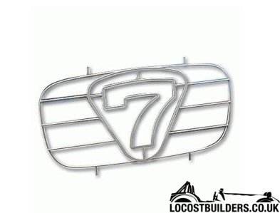

| posted on 1/4/09 at 12:26 AM |
Found a really simple and easy way of doing mine with this type of grill:
http://www.locostbuilders.co.uk/upload/nose_conegrille.jpg
You see the 4 pins that point up and down from the grill.
I cut the bottom pins in half.
Then drilled 4 corresponding holes in the lip of the inside of the nosecone.
Then fit the grill pins into the upper holes first and then slot it downwards into the lower holes. It'll then stay there fine.
Zero added weight, cheap (well, free) and simple to do.
HTH,
James

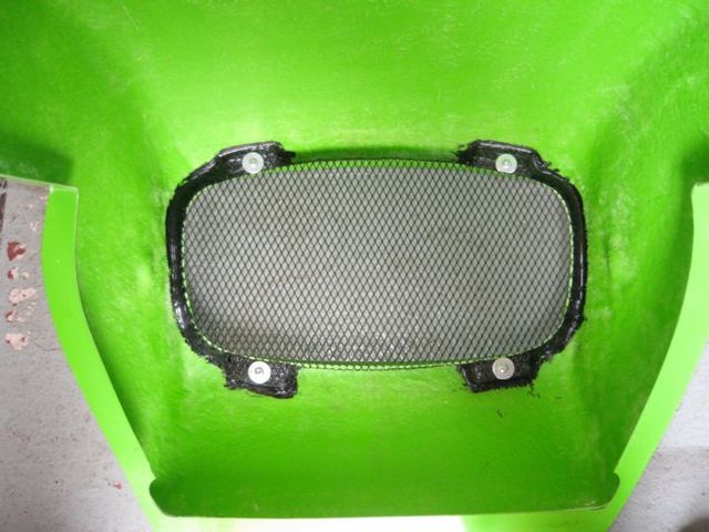

| posted on 1/4/09 at 08:24 AM |
hi i sikaflexed 4 pieces of wood in each corner then screwed 4 screws with washers to hold the grill in place. Also run a bit of sikaflex around the
edges. more pics in my archive.
[Edited on 1/4/09 by dunk3]
