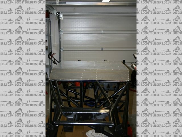

| posted on 8/10/12 at 11:41 AM |
Here's a picture of my floor panel. Not the best one but it'll give you an idea. The panels were also glued uring PL 400.
ElmrPhD
| posted on 8/10/12 at 11:46 AM |
Thank you Fege!!!
Wow - that's indeed about 1-inch/2.54-cm spacing. Ugh - gotta go buy a bunch more rivets!!!
Let me ask you - is that your work or is that what MNR delivered pre-assembled?
Thanks again - you're my new best friend!
Steve, in the NLs

fege
| posted on 8/10/12 at 12:14 PM |
That's my own work! My arms looked like "Popeye the sailor man" as I was using a regular manual riveting tool...
