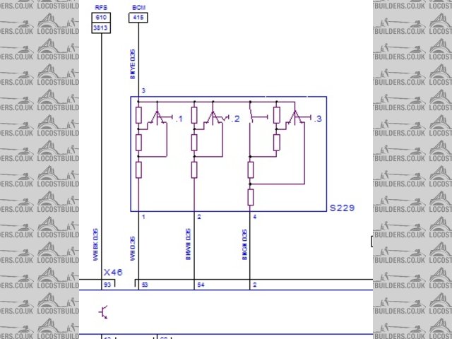

DW100
posted on 7/12/15 at 08:40 PM |
Here Is an Internal diagram of the switch
![](/galpreviews/Corsa C indicator switch.jpg) ![Description](/gallery/Corsa C indicator switch.jpg) Description
S229.1 Switch - High beam
S229.2 Switch - Turn signal
S229.3 Switch - Cruise control
Nothing clever it is just a voltage divider circuit. No active components inside.

Huttojb
posted on 7/12/15 at 09:12 PM |
DW100
Brilliant. Your a star!!
This is perfect, been trying to find this info for ages.

Yesterday I spent some time with a Corsa C indicator switch and discovered the following (using that previous diagram in this thread as a
reference)
Pin 3 (brown/yellow) - common feed
Pin 2 (black/white) - Indicator functions
Pin 1 (white) - dip & flash functions
My resistance measurements were:
Pin 3 (brown/yellow) to Pin 2 (black/white)
Indicator functions
Centre = 1.45 kOhm
Left = 0.48 kOhm
Right = 0.15 kOhm
This connection did not react at all to beam/flash funtions
Pin 3 (brown/yellow) to Pin 1 (white)
Beam functions
Neutral position = 1.48 kOhm
Flash position = 0.49 kOhm
Dip position (this does not latch btw) = 0.15 kOhm
This connection does not react to indicator functions
(Incidentally I had some trouble with another multimeter providing very unstable readings so YMMV)
