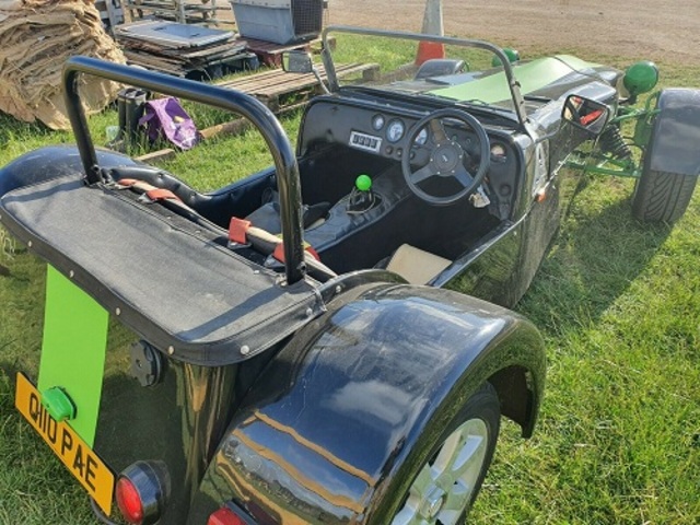

First 4 hours in to ownership
and how she is looking now

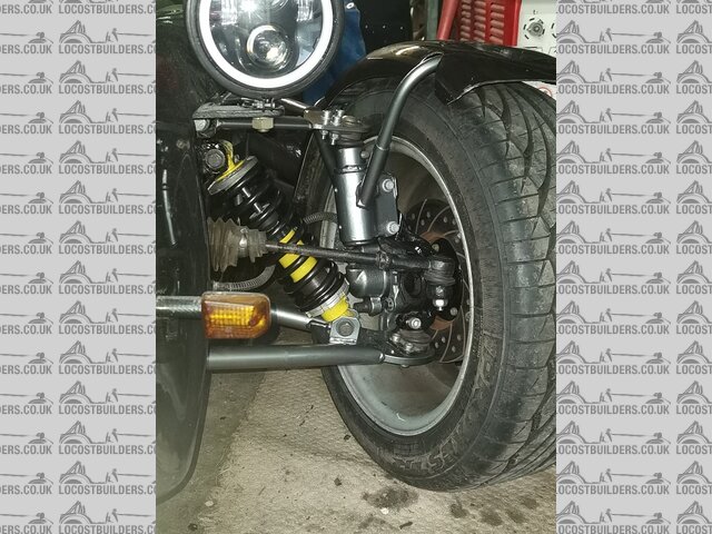

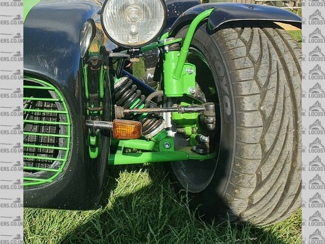

The next big issue was handling she drove like a pig, would turn right great, not so keen on left, everytime you hit a bump it would try to leave the road.
The handling was down to a poor setup. the rear axle was 2inches of center due to badly adjusted panard, one rear shock was set to full damping and the other min damping, tyre pressures all round where 32psi. Front end drivers side had full posi camber and the pass side was full neg camber and about 5 miles of toe out, so now this are all reset she drives so so much better.

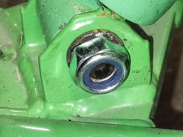

The previous owner had the front suspension removed and powder coated which will be why the geo was all over. BUT Not sure who is responsible either the previous owner or the garage but they should of been shot. it has had a load of new fasteners in the front suspension which is nice but every bolt/nut was far from tight, nipped at best which is bad enough but every bolt was that short in length they did not protrude into the nylon on the nyloc nuts. so barely tight nuts with no locking method, That would be fun at speed.
The 2 bolts that hold the VW upright to the upper ball joint are just normal bolts not the eccentric washer type not huge deal just makes camber adjustment a bit more fiddly. but then spotted they have used the eccentric washer bolts to hold the shocker top mounts.
Its really basic engineering principles make sure the bolts are the correct length, i have always worked on the priciple of you need atleast half the diameter of the bolt protruding beyond the nut.

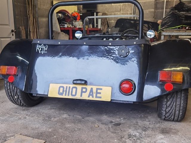

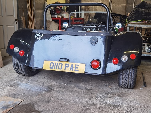

The rear end always bugged me the handbrake cables where hanging out protruding beyond the rear panel and hated the trailer type rear lights and the green is not my cup of tea etc.....
So rerouted the handbrake cable so now they are tucked up, lifted the number up and leveled/centered it, unfortunately cannot get it any higher as it is hiding the cutouts in the rear panel from when it had a spare wheel carrier.
Then at this point saw that the number plate was not level or centered, which lead me to see the green stripe was off centre and not level, to which I happily removed, (plan is to de-green the whole car)
Next was the rear lights not a fan of square lights and even less of a fan of them been 1.5 inches out to each other, so some nice landrover type lights, and the fun of fitting them to hide the old holes and keep them equal to each other etc....
Lights before
and now

Well operation De-green or De - Kermit as the wife calls continues, all the wish bones have been repainted Spax Coilovers taken to bits and repainted. etc..... took a while to put everything back together as I spent a lot of time going through my many biscuit tins of nuts n bolts as I wanted both sides to mirror each other hardware wise,

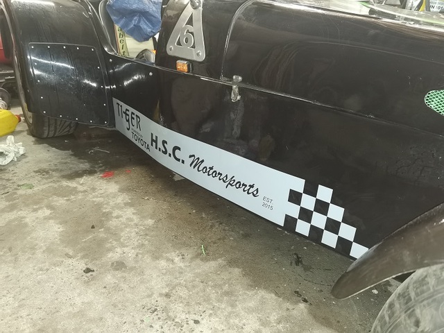

Headlight buckets and grill are all painted now just waiting on the clear to cure then get them fitted tomorrow and the car is nearly de-greened
and for a bit of fun had a play with the vinyl plotter again and made some side stripes for the car. I am not a 100% sold on them I was just cut from some left over vinyl.
The H.S.C. came about 5 years ago when I was building a track car, the garage I use is at my mam and dads property which is called " Hall Station Cottage" hence H.S.C. motorsport was born and every trackcar and toy since then has had the HSC motorsport.

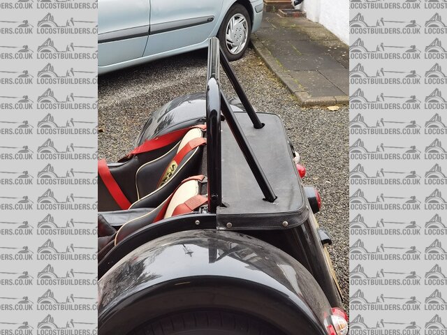

Not done a great deal, but did do a job that had been bugging me for a while, never liked the look of the single roll hoop, personally thought it looked a bit fragile, so raided the pile of scrap steel at the back of the garage and found some 32mm x 2.4mm steel tube. welded some 6mm mounting plates to chassis, the end of the tubes have a bung welded in the end and tapped to m12, all refinished in ford panther black (had some spare from another job)
Its one of those jobs that only cost time using bits I had lying about and i think the car looks alot better.

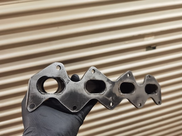

I needed some way of mounting the ITBs to the engine I could of put my hand in my pocket and bought a premade one but they are not cheap so made one from 2 lengths of steel from a old towbar and some exhaust from a nova.
Its now at the stage that it starts and revs etc.... still a but more tuning to do but so far happy runs cleaner than the carbs and seems a lot more responsive.

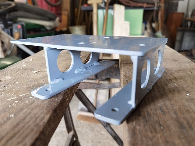

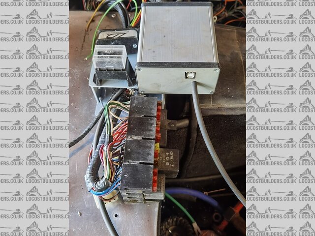

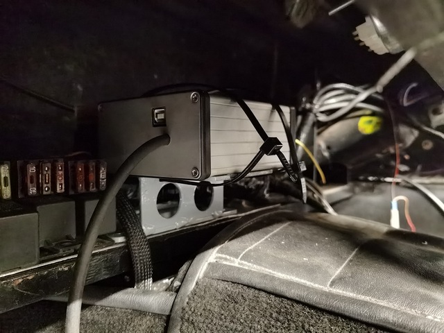

Made a little bracket up to hold the Speeduino ECU, due to space limitations I wanted to mount it above the the Tiger loom and towards the rear of the car to give me clearance from the scuttle, all the wiring is now complete I kept the Speeduino/injection system as seperate system,
Little mount bracket made from scrap steel.

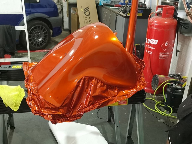

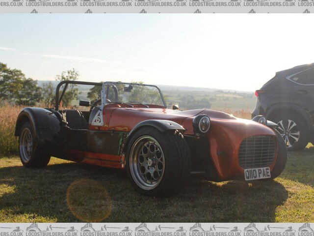

Cosmetic re-vamp is under way, nose cone, bonnet and rear wrapped in burnt orange, sides and wheel arches are staying in black.
The orig gel coat was looking tired and dull, my friend owed me a favour or two so I cashed them and he has started to work his magic.
I cut some new sidestripes out in the same vinyl to tie it all together

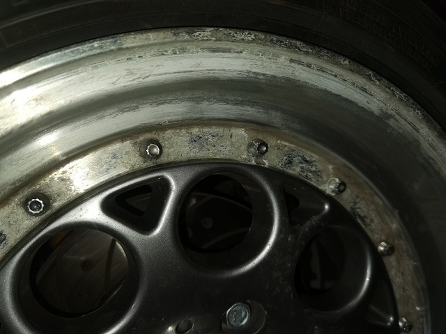

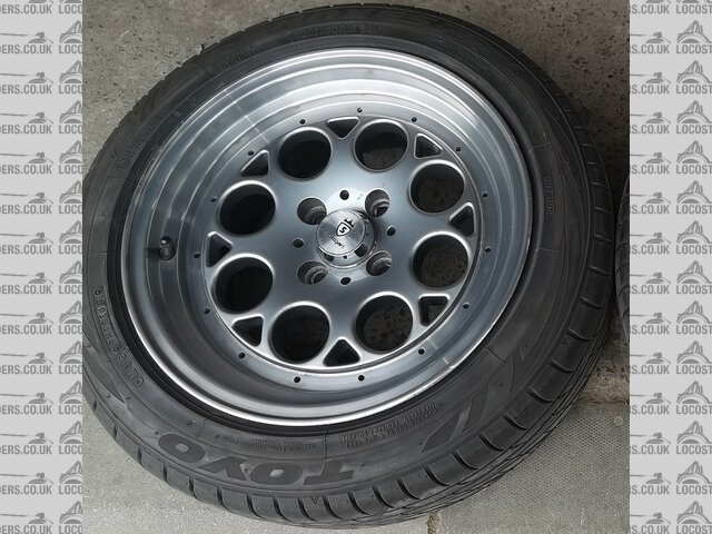

A few months prior to wrap job I bought a set of new to me wheels they where cheap and very rough condition, but mainly cheap,
So after some elbow grease they came up well,
I used my car as lathe, removed the tyres, bolted the wheel to the axle and engine running in second gear we got to polishing.
Preclean
Post clean
