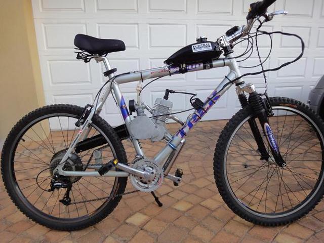

Slater
| posted on 29/3/12 at 07:15 AM |
Wow. This is an excellent thread, I can't wait to see the final product. I only found it yesterday! Keep posting the pics and updates.
It certainly beats my home made bike.
Why do they call Port Harcourt "The Garden City"?...... Becauase they can't spell Stramash.
| posted on 29/3/12 at 08:54 AM |
I like it! What engine are you using?
