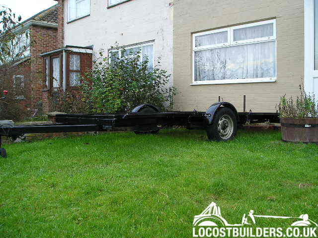

This used to be a caravan
  trailer
  Trailer2
http://www.locostbuilders.co.uk/upload/P1010300.JPG
Its the basic caravan chassis with 40x40x4 angle wleded on top for the bed and cross pieces. The bed is ply, cant remember if its 18mm or
thicker.
It towes lovely with my locost on it and iv had just over ton on it which wasnt a struggle. Just made the suspension sit down a bit.
Total cost about 150 quid and that included the bradley double lock hitch. Took me a week of afternoons to build.

If you want a car transporter the deck would be quite high to clear the wheels so you would need long ramps
That is the trouble with mine but it works well. If you look at my deck it is in between the wheels. My front goes through there with a few inches
spare.
