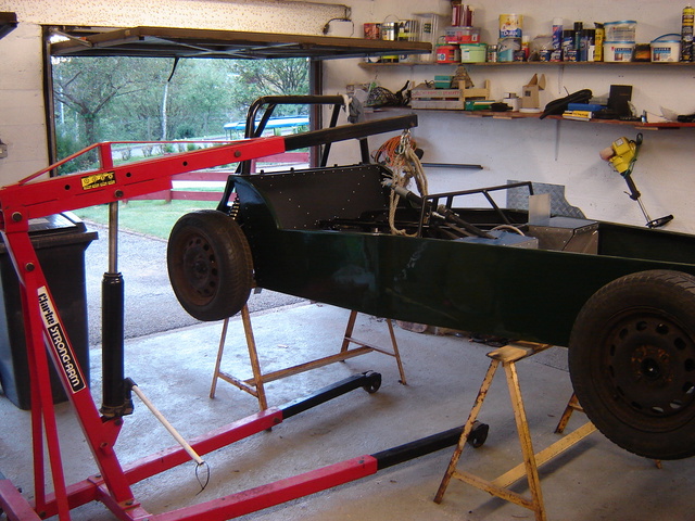

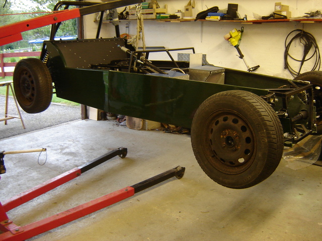

I did it like this with an engine crane with extandable legs.
............but then found the chassis landed on the cranes legs before the wheels hit the ground!!!!!!
Sorted by some big wooden blocks to land the chassis onto.
[Edited on 28/6/12 by Slater]
