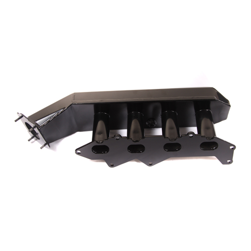

Ok it took an hour but I found the pics.
My opinion on it. I can see no provision for the ford idle control valve. This is really needed with the eec family of ecu's. It can be got
around but the ford one works so well. So its still aimed at aftermarket ecu's ie omex / megasquirt
You still need a sandwich plate from an early Fiesta / Escort to mount the injectors. At least with the griffin you could just stick your injectors
into the new manifold. Its saved a few pence in steel and a little labour.
I love the shape and length of the runners and really like the proper bell mouths inside the plenum. somthing that you couldnt really do with the
griffin.
Price £235, look forward to seing it at Newark.
