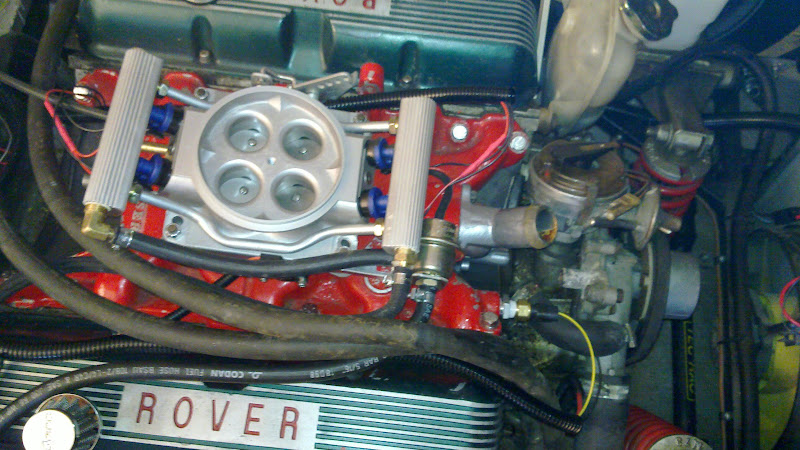

posted on 18/7/10 at 11:23 AM Reply With Quote
Here's the TB/Manifold in situ
