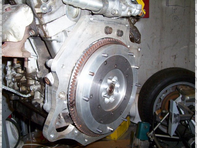

I made my own custom flywheel - as said it is just round bit of ally.............
  Ally flywheel / adapter plate
I've not had it balanced - I only rev it to around 8000 ....................

mcerd1
| posted on 18/3/10 at 09:31 PM |
shouldn't cost much to get ballanced - I got my whole bottom end done (burtons flywheel and cossie crankshaft) for ~£50 I think
one machined out of billet shouldn't be far off, but I'd still rather have it done
