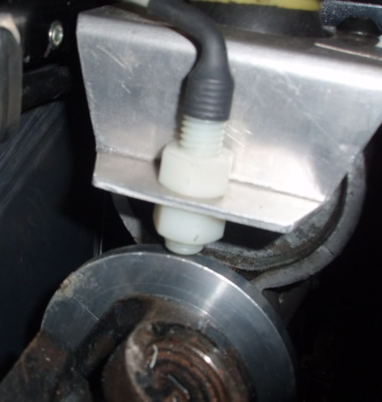

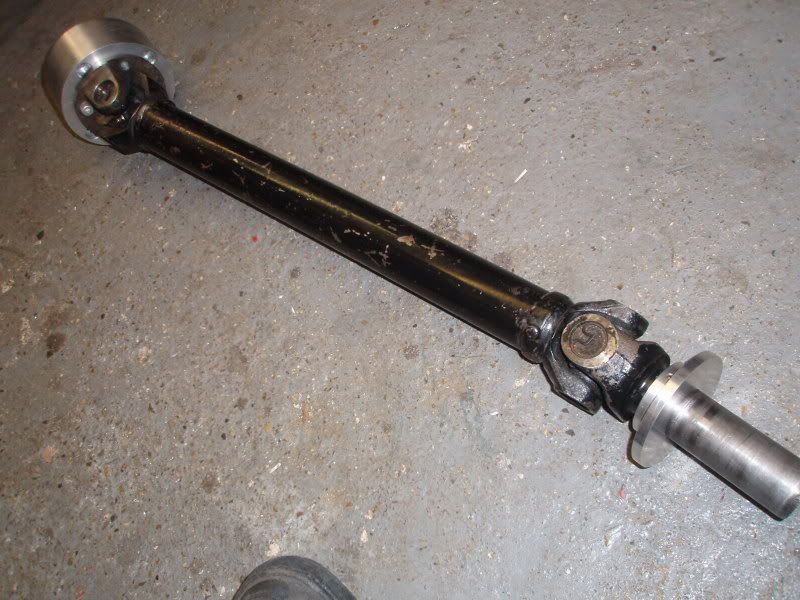

robinj66
posted on 26/11/08 at 02:21 PM Reply With Quote
Have alook at my picture on
here
