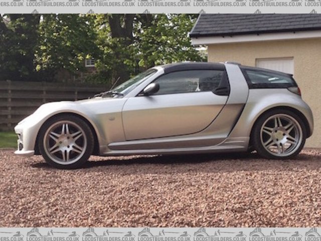

I recently bought a Smart Roadster Brabus Coupe. Got it rempapped to 125bhp and it's actually quite a hoot. You just cane it everywhere you
go, feel like you're going eleventy-million miles per hour, but in reality you're barely troubling the speed limit!
I heard a lot of moaning about the gearboxes, but that has to be about the standard auto boxes surely as the flappy-paddle model that mine has changes
faster than I could with a manual.
The only thing I don't like about it is the ABS based traction control system - it is far too intrusive!

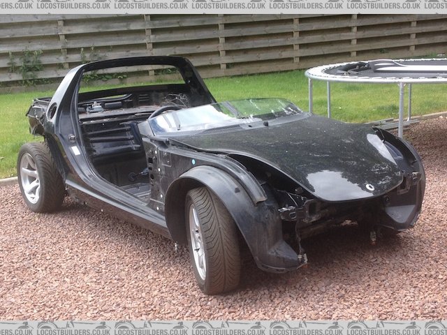

How about a stripped-out, basically kitted, mega-lightweight jobbie!? It'll give me something to faff about with until the Arion is built, or
until I get bored and take the pile of junk I've bodged to the scrappy!
So I picked up a rolling Smart Brabus Roadster chassis (non-coupe) with V5 for pennies from a breakers. I went with the non-Coupe as it's
lighter and I wanted to cut the screen down (the coupe wouldn't look right with this done).
Surprisingly, there's not a lot of swap info out there. I've seen that a guy put a Citroen VTR engine / auto box in one. And there are a
couple of GSXR cars (especially in the ForTwo range).

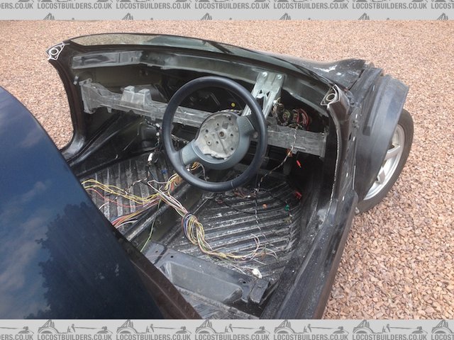

So far I've stripped it's entire interior out, removed the heavy doors, removed the PAS components, removed the rear window, and chopped
the screen-glass down just to see what it might look like (pic below).
Will get round to making a lexan screen, a simple ali-sheet dash, and put in some GRP seats. I'm confident I can knock 100kg + from the
original 790kg weight (even with a four-pot engine swap).
The only fabrication work will involve a couple of mounts across the front chassis legs to take the relocated fuel tank, plates to tidy up the
windscreen pillar legs, welded in harness brackets, a clutch pedal, couple of side impact bars across where the doors were (I'll attach the
plastic door-skin panels direct to these bars. Oh, and new bracketry on the rear sub-frame to take a different engine / gearbox!

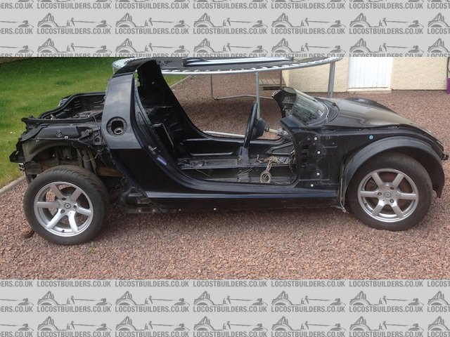

Must be a physically small and light unit as there's not a lot of space back there (see pic of a Rover K-series block in the subframe).

I bought my wife a Roadster Coupe at the beginning of the year as a birthday present, though I had to completely rebuild the engine (factored into
purchase price). It's more fun than most cars I've driven, and it's no slouch at lower speeds. However you must change gear pretty
slowly if you think the Roadster does it faster than you could! It's not as terrible as many people make out and it certainly has it's
charms, but it's slow enough that you have to learn to anticipate the box to get the best from it. Fully auto mode is virtually useless as
well.
