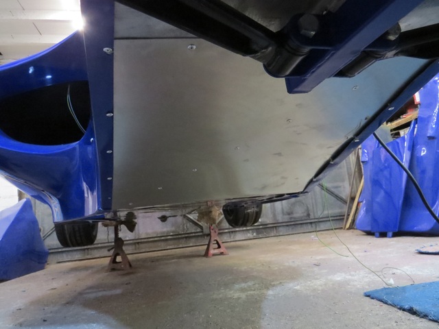

| posted on 19/7/17 at 12:33 PM |
Day 43, after much grief with their website the IVA application has now gone in! They will now only accept online applications through their website,
unless you find yourself unable to make the app online, in which case you have to contact them & they will then allow you to make it by mail -
they will NOT accept an email application! Having wasted a fair chunk of the day with IVA application, was quite pleased to get as much done as I
have. Rear no. plate surround, fog & no. plate lights fitted along with mini loom attached to rear lower engine cover, made the cut outs in same,
cut the sides down to fit past wheel arches (the lower rear deck is made to fit with different wheel sizes/spacers etc. so usually needs narrowing
slightly) & cut the side pod floors & fit/rivet. They are different to each side as the OS is open behind the radiator to encourage a
Bernoulli effect helping to suck air thro' the rad

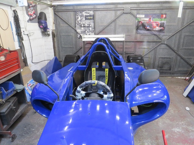

All of main build complete on day 45! Last couple of pics of edging to arches & chassis no.s, had a bit of matt black to blow in on the rear
upper engine cover securing strap, setup Acewell & check speedo, set gear/speeds so it can tell what gear you're in. Brief roadtest up &
down drive, jack up & check each brake individually. Last job to be done is to check emissions, I now have the info I was waiting for re the Power
Commander, so hopefully that should be straightforward. I won't post again until after IVA which is some way off at present, going to Leighton
Buzzard as they've now closed Edmonton. Meanwhile if anyone knows of any good decal/graphics manufacturing firms &/or wrapping companies in
the S.E. then please let me know, I'll be doing a separate post re getting the graphics/paint/wrapping done

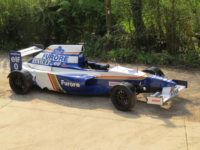

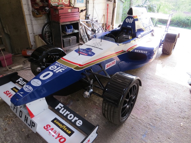

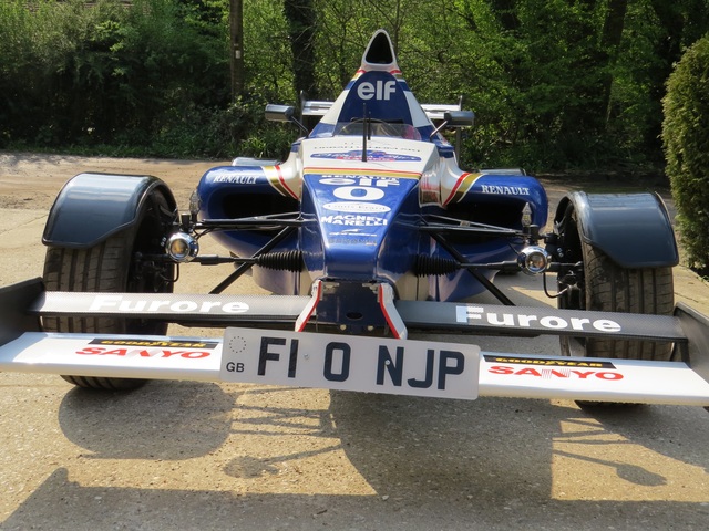

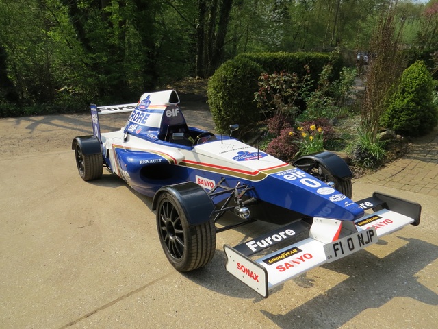

| posted on 24/4/18 at 07:00 PM |
Been a long time b4 I wanted to post the final pics of the car. Registration took nearly 2 months, but got it on the road for shakedown tests &
immediately had an absolutely bl**dy awful issue with the ECU going into a really harsh limp home mode, snapping ignition off & back on several
times a second when you hit 3,000rpm! Turn it off for 30 secs, turn it back on, fine, for maybe 2 miles maybe 10, maybe more, but knowing
it's still going to do it again ..........
Never had anything like it b4, but never had a 2016 engine b4 either. To cut a very, very, very, long & stressful story short, many learned peeps
were telling me this was the ECU not "seeing" ABS, traction control, the dash etc etc, after a visit to Rage motorsport for a reflash
& no further forward & sending the ECU to the States at some considerable expense to have the problem half fixed, in that it now only cut on 2
cylinders at 3,000rpm! Add to this that I still had to get the car to & from the wrappers for the bodywork to be finished - not a fun time
I eventually returned to basics & removed all changes to the loom with the exception of removing the sidestand switch wiring, this sorted it,
minor detail now being you could only start the car in neutral, not good if you've just managed to do something daft & stall it in a higher
gear. To reinstate being able to start in any gear was way harder than expected, but eventually got it sorted - the rectification did not follow logic
whatsoever, but it now has a press to start in addition to the ignition switch.
Fortunate that I had a very understanding customer & we had a really cr*p, cold & wet Winter so he didn't want to drive it anyway!
(tho' that didn't make road testing easy or pleasant either! as, of course, it would never exhibit the problem in the garage, that would
have been far too simple!)
All's well that ends well & he took the car last w/e & it now resides in the Tamworth area, he's a happy bunny & I've
learnt an awful lot about ZX14's - firstly, NEVER listen to advice from anyone else!!!
I think it looks absolutely fantastic, quite the prettiest Furore I've built & doesn't so much turn heads as rip them from
people's neck's!
I hope at least some of you will agree with me
The last pic is one of the car it is intended to be a tribute to, I feel it's a reasonable resemblance
