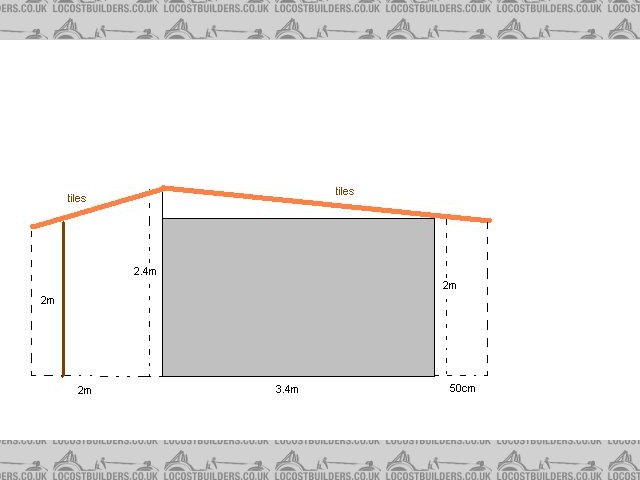

l0rd
| posted on 7/7/12 at 03:03 PM |
this is the one in question
the brown line is supposed to be a column
[Edited on 7/7/12 by l0rd]
l0rd
| posted on 7/7/12 at 03:10 PM |
Zilspeed
The roof as you can see in the image is nearly flat.
1) Do you want a level ceiling inside or can you make do with the ceiling following the pitch of the roof.
the ceeling will follow the pitch of the roof
2) Will the roof drain at the perimeter or somewhere in the centre.
the roof will drain on the front and back.
3) Do you have a suitable wall head arrangement to use a simply supported joist ?
The utility room in question have 20cm level thick walls arround. The dimensions of the room are
6m wide by 3.4m long
4) Do you need to insulate in any way ? (I see you're in Greece.)
Between beams, i will use plasterboard and insulation? Not 100% sure where insulation will go but there will be insulation.
