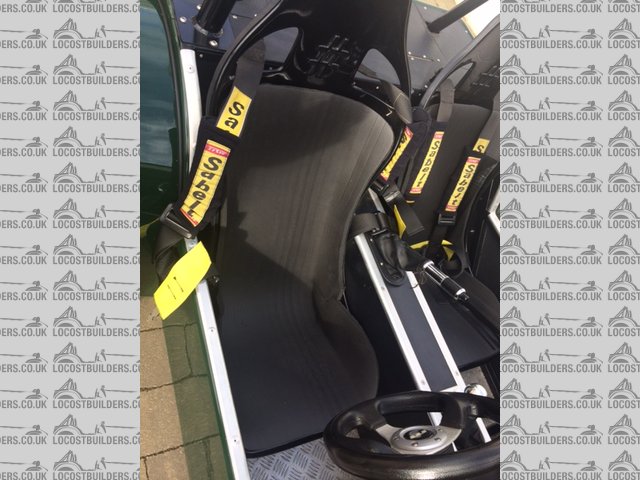

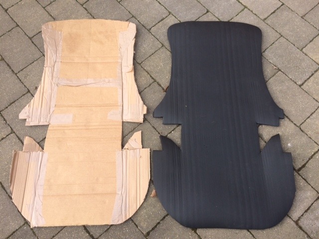

I've made some seat pads for 2 reasons, one, to stop me sliding side to side in the MAC#1 fibreglass seat ( I am quite narrow so needed some
wedging in) and two to try and make the seat a bit warmer, as I drive it all year round.
I ordered 2 yoga mats from amazon, 15mm thick, 15 pounds each. Then experimented with cardboard template to get the best shape for the bucket seat, it
was quite tricky to get the bit either side of my hips right. Once happy with the fit and size I cut the mats using the template with a sharp
retractable stanley knife, ensuring to make just one cut through the neoprene foam, a second go with the knife just ended up with a ragged edge. I did
the cutting on a big sheet of plywood.
I also made some half thickness cuts in the back of the neoprene where I needed it to bend.
Once done it fitted nicely in the fibreglass seat and reduces the width at my hips so I am nice and snug in the seat now. No need to fix/glue/velcro
the pads in either as it seems to stay in just fine.
Quite pleased with the result, its certainly holds me in better and its a lot warmer. Just thought I'd share this as a cheap and easy winter
mod.
