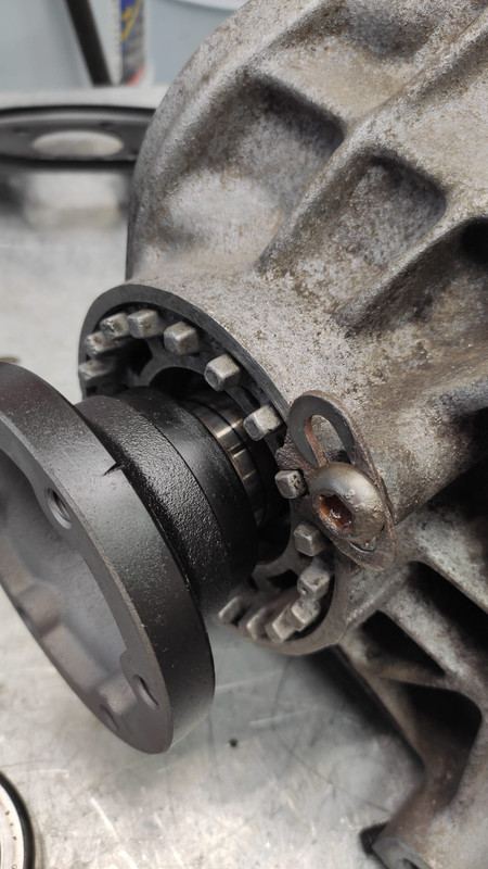

here you can see photos from dealer.
HERE i think it's similar problem with trans-x lsd:
This differential lock is only available for FORD 7" differentials. All Caterham with 7" differential always have the version with plugged drive shafts. Various replicas use the 7" differentials with inserted shafts. If you supply us with drive flanges, they must have the same length and an intact retaining ring for us to be able to provide this Tran-X lock. Otherwise, the appropriate drive flanges must be purchased from Quaife.

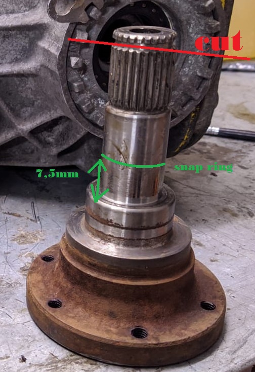

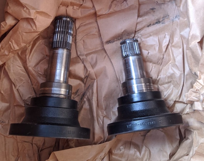

flange of ford lsd have different lenght, one it's too short and other it's too long, so i need anyway another couple of flanges and the ideal one come from open diff (thanks to CosKev3).
here flanges from ford viscous lsd
here you can see open diff flanges
will be modded like this.
where you see washer it's the seat of snap ring on titan unit.
