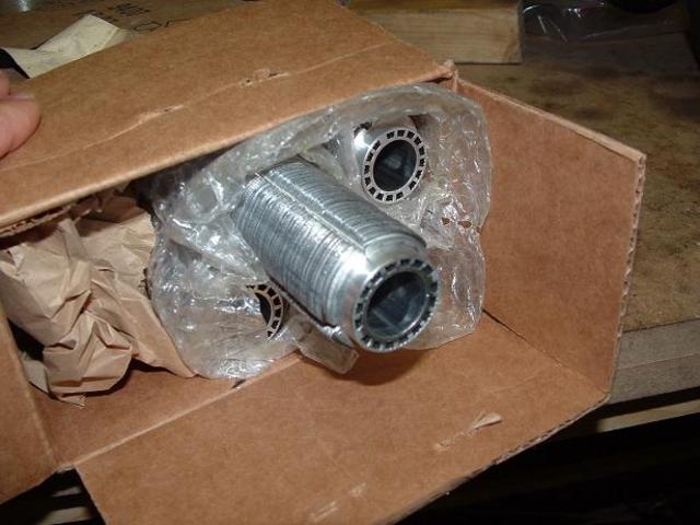

4 laminova IC cores 80 euro's (125 each)

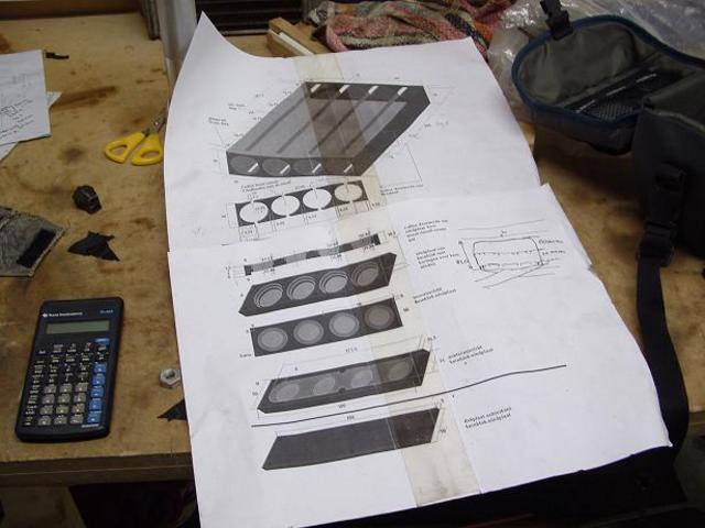

the desings ready to CNC the core housing (took 3 months)

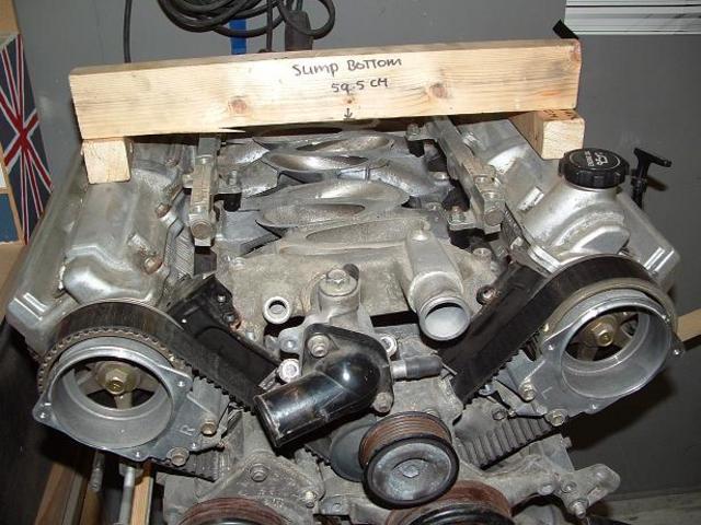

the piece of wood that says 59.5cm to sump bottom is 0.5cm under the bonnet line, everything needs to be lower than that!

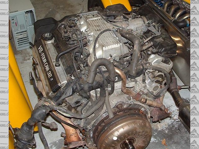

the engine as I bought it
  1uzfe engine

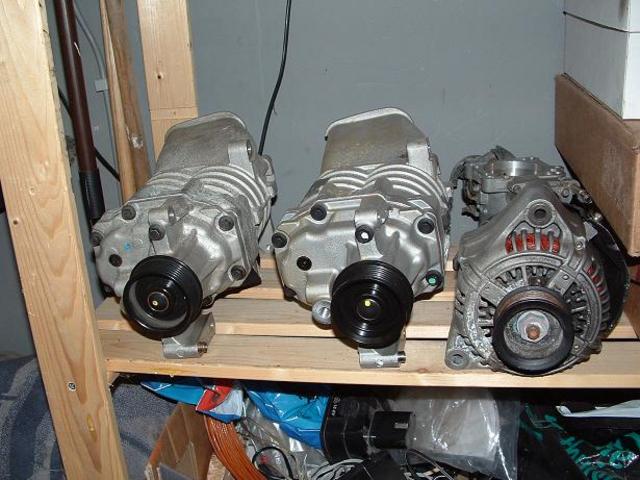

Twin Eaton M45's
  Mini Cooper S, eaton M45 Superchargers
The intercooler cores
  Intercooler core detail
The core housing desings
  IC core housing drawing

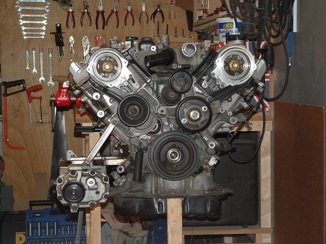

update twin supercharged 1uzfe

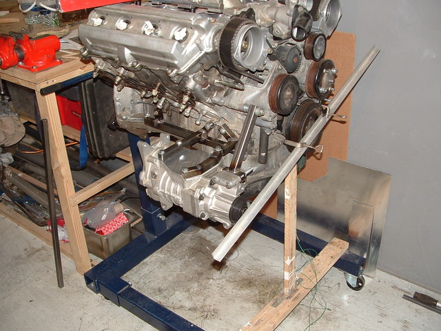

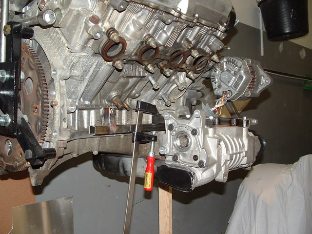

after setting up my new garage toy I thought I'd have some play with making up a few mountening brackets for the lefthand side M45 today (girls
out with friends..... whatelse would you do?)

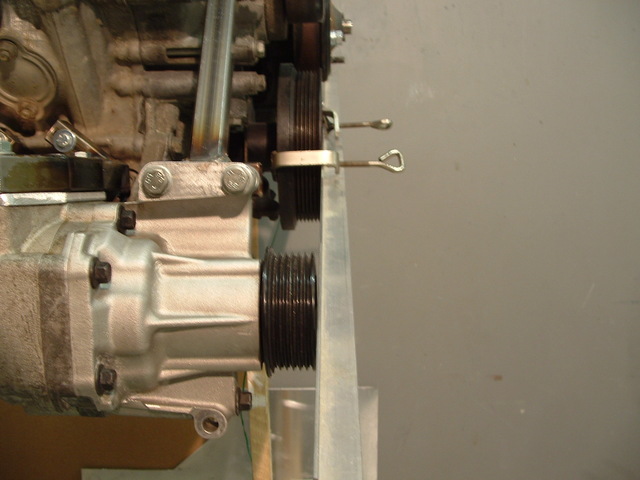

anyway I managed to make the first smalltime c**kup on the SC's I have made the vertical mount, but without having the outlet flange on the
supercharger, (only the carbboard cover is on now) the flange will be 6mm thick so the mount is now 6mm to short... ah well cut and shut will probably
solve that. otherwise it might prove usefull on the other side.... Oh jolly I need to do another one....
it's not fully supported on it's own yet, because I didn't have the time today to get the pulley's lined up perfectly. so once
that's done using clamps I'll weld the 2 outlet mounts up to the horizontal bar which is allready on the engine.
just to make an excuse for the piccie's, this is the first all by myself purpose made weld EVER!, I doesn't look really good, but they at
least stick.... (who was that mr silicon orso?)

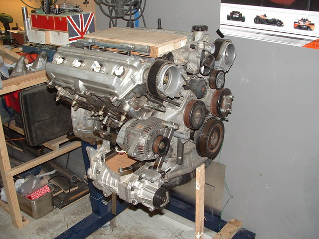

So another day of fidling with the engine now sees #1 supercharger mounted to the engine, and the outlet flange made up, I've done that by hand
completly using nothing but a hacksaw and a few files, and once again Oh jolly I need to do another one.....
here's piccies
the allingment of the pulleys is spot on in real whereas the piccie shows an offset gap between the ruler and the pully, it's within 1/10th of a
milimeter overall.

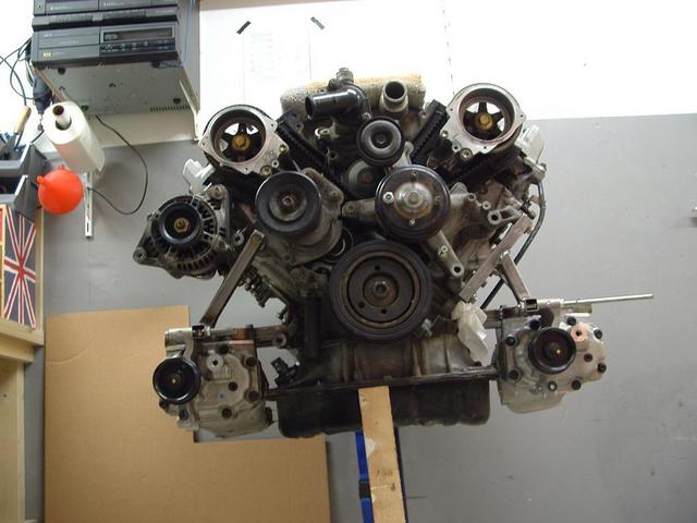

updated!
Hey all,
after a few moths not working on the engine at all,
(lets just say that 2nd half of 2007 goes in a box and the box will burried on the north pole)
I've finnaly got around to get some quality time in the garage. so late december sees supercharger #2 fitted to the right side of the engine.
the brackets will be also suited with round tubes inside where the bolts pass through.
this one was allready on but there's now a 4age alternator with the 6rib 1uz pulley attached
  left side + 4age alternator
Right hand side #2 eaton M45
  rightside eaton front
front of the engine I'll only need 1 extra support pulley for the belt run,
  engine front view TWIN eatons
sump stays the lowest point of the engine. it may not be higher than 60cm with intercoolers on top of the inlet manifold.
  Twins fully mounted
belt run

oadamo
| posted on 28/12/07 at 11:51 PM |
id check first you can get a belt that big
adam
thomas4age
| posted on 29/12/07 at 12:42 AM |
Gates have 6rib belts from 28.8" up to 120.3" in +/- 1.5" increasements, so there must be one availeble,
I could fit another 5 sc's propably before the longest one is to short, whahaha
OT but handy to know, gates numbers:
K06 means 6 rib belt (K04 = 4 rib)
in the # K061203 it says
6 rib 120.3" long on inner length (rib side)
in the # K060288
6rib 28.8" long on inner length (rib side)
the metric coding is like this,
PK62245
PK6 = 6 rib
2245mm long inner length (rib side)
the original belt is 2245MM (88.3" long
so that's covvered, there's a tension pully with a spring attached so that has some play, lets just hope it's strong enough.
grtz thomas

I've seen guys run single M90 compressors with unsupported lengths bigger than my layout on the previous page , they dont seem to have problems,
there's also one difference in my system, the complete load of the SC system is devided over 2 pulleys, so belt slipage on the chargers should
be OK (mini sport don't have problems with up to 220hp)
I'll measure the longest length unsupported but doubt that it is longer than 25cm. this engine is tiny
@ blueshift: I think I'll be allright, in the original mode it's about the same and I don't run a very big electrical system + the
4age alternator normaly runs on a 5 rib belt and it's niow converted to 6 rib so additional friction is allready there.
I tried to get as much wrap around the cranck pulley and SC pulleys I could, and was even willing to move the alternator to the driveshafts on the
gearbox.
@Mave, Nice man going on the Zetec I suppose? if you find anything that let's us connect a throttle bodie to the supercharger entry please let
me know, still looking for a cheap well thought solution.
Grtz Thomas
If Lucas made guns, Wars wouldn't start either.

Hi Thomas,
Unless someone else has already done this same setup before then its just something to be aware of when the engine initially runs. Just get someone to
watch and blip the throttle on off sharply to see what happens. More of a problem though if you don't have any sort of sprung tensioner in the
system like on my engine!
In the picture below the small pulley at the top was added as a precaution against whip. Not to provide more wrap as you might first deduce. The OMEX
installation has very similar belt runs to mine but they don't have the pulley at the top. On the rollers their setup spat off a belt on the
first day of tuning. So they went away and revised their design. They still don't have the top pulley so maybe they have a sprung pulley at the
bottom.
Justin
