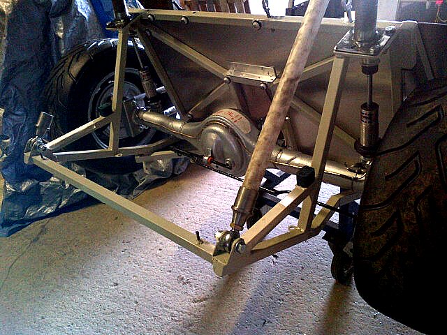

I was wondering the same now that my axle is in.
What's the capacity? Will a quart be enough?
MK9R
posted on 17/6/13 at 03:30 PM Reply With Quote
Yeah 1 bottle is enough, but buy 2 so you can top it up when the bearings start to leak seriously buy 2 just to keep it topped up
