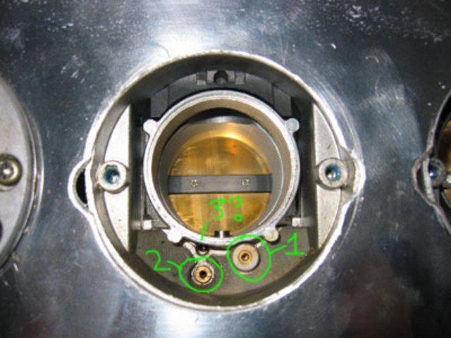

r1 carbs-which hole do i block?
just been reading through a previous threadhttp://www.locostbuilders.co.uk/viewthread.php?tid=67564
[Edited on 18/6/07 by adrian]
[Edited on 18/6/07 by adrian] Rescued attachment r1carbholes.jpg
skydivepaul
posted on 18/6/07 at 08:59 PM Reply With Quote
hole no 1

posted on 18/6/07 at 09:23 PM Reply With Quote
Yep, hole number 1.

adrian
posted on 18/6/07 at 09:59 PM Reply With Quote
thanks guys!
oadamo- i think its to improve the response of the slider?
can anyone provide more info?
smart51
posted on 19/6/07 at 07:11 AM Reply With Quote
the jet that you block feeds air into the needle jet. What I think it does is lean the fuel off at high revs / full throttle whilst keeping the fuel rate up at mid revs. This is to match the restriction in airflow caused by the exhaust / airbox at high flow rates. When you fit freer flowing parts to your engine, you want a more linear fuel flow so you block up the hole.
