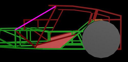

Hi all,
I’m building a hard top version of the Locost and wondered is people could look over me design and let me know what they think.
Key:
Red = Stuff I have moded and added
Cream = Guides just for viewing
Blue = Ali frame for nose cone and rad
MikeRJ
posted on 27/10/07 at 12:31 PM Reply With Quote
Adding those door apertures will have severely weakened the structure, and I'm not convinced the roof will have put much back in as you are stressing the "A" pillars in bending, and the roof bars are not straight (thus prone to buckling as they will be in compression).
If the roof structure is going to be made from a substantial section material to also act as a roll cage this might not matter so much, otherwise IMO an extra diagonal on either side would help greatly:

i like the look of your design a lot, its similar to something ive considered, a locost with a hot rod style look in the screen. The door apetures wont weaken it from a standard locost chassis since nothing is missing, however, i would recommend a good cage anyway!
Nothing missing except the upper rails of the spaceframe between the scuttle the seat panel
Should be possible to strengthen it by beefing up the tunnel to make a backbone TVR/Cobra style.
I'd suggest building a balsa model to see what's going on stiffness wise.
oops, my bad! I only looked at the side view where the tunnel seems to replace it!

What do we think of this for a backbone?

MikeRJ
posted on 28/10/07 at 02:20 PM Reply With Quote
Only if the rear end is redesigned for it. Removing the outer rails and just beefing up the tunnel structure will just mean all the bars in the rear bulkhead will be put under lots of bending force.
As the option of adding a structural roof is there, it would be sensible to take advantage of it; could probably made made quite a bit stiffer than a standard locost if properly designed.

How about this:

Firstly this thread is going to be of limited value to you as I don't see anyone volunteering to build you a balsa model or do an FEA analysis of the design and without doing either of the these its kind of pointless "imagining" where the loads will go IMHO.
Secondly as MikeRJ says, the roof if done properly could add hugely to the stiffness of the car. And could be make much stiffer than a regular locost.
Lastly when you look at stiffening a part of the car like the tunnel you have to consider how the loads are going to get in and out of that area. For example if the connections between the tunnel and suspension and shock mounts are not stiff enough to cope with the increased load then you'll just be bending that part of the frame instead of the tunnel.
