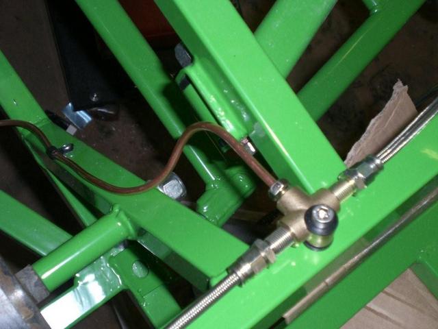

When i did my floor, i turn the chassis uoside down to rivet the floor, loads of room for a lazy riveter between the roof and chassis
Also on your rear brake 'T' piece, whats with the 2 small copper pipes coming out, your braided hoses should screw into the
'T' piece.....?

| posted on 13/12/08 at 01:23 PM |
like this

The braided hoses will fit to the little copper pipes. Just to make it a bit easier to fit... Marks advice!
The rivets in question were the outside edge rivets, I had already don the rest 'upside down.'
Just by now the car was a bit heavy to just flip over!

grusks2
| posted on 13/12/08 at 06:25 PM |
Now i know
