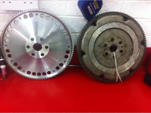

Without further ado, I thought I'd at least do an interesting weightloss post, which is - I've got my new lightweight flywheel. 12.3 down to 3.7 KG, I think. This should make it interesting.
Here are the photos for your onanistic pleasure:
Front On
Side On
Arse On

That new flywheel makes the original look like a right porker, mine is an ST150 so not as big as that similar to yours but without the holes.
Keep up the good work, I'm not far away from you being in York.
Kev
http://www.triangleltd.com
posted on 23/3/12 at 09:34 PM Reply With Quote
Is the OEM one a DMF type flywheel.....? Looks gargantuan by comparison.
FuryRebuild
posted on 23/3/12 at 11:38 PM Reply With Quote
Yup. Dual mass = many pies.

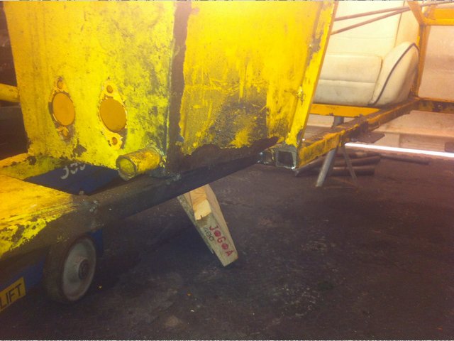

I now have the entire front of the car back to the chassis, apart from the brake master cylinders and pedal box. I'm leaving them in situ just at the moment because I need to convert the clutch pedal from cable to hydraulic. The plan is to cut the necessary circular hole in the right place and fir a bearing in place in the pedal to take a clevis acting on the master cylinder.
I've started to take the side panels out, drilling out rivets and whatnot. One option would be to leave them in place and get them powder coated with the rest of the chassis, but I just don't know if the rush has got in behind them. I'm going to go with plan-B. Get the chassis blasted (a nicely keyed surface then) and epoxy the panels in place, securing with advel stainless rivets. These have upwards of 3000PSI clamping force rather than the crappy soft alloy ones. You can't put them in with a hand riveter, but luckily I have an air-riveter. I may get the chassis done, then epoxy them in place. Assuming the job is done well, I will be putting epoxy onto epoxy - not a bad idea if it's keyed first. Saying that, just writing that down makes me want to go with plan-A.
I've also got the rear hubs and half-shafts out, and everything split down as needs be (again, the original IRS installation rear hub carriers are rusting to buggery).
The half-shafts are in good condition. I will probably replace the handbrake cable. I've changed one without the car being stripped down and it's a hellacious job.
I kinda wished I hadn't stripped things back so quickly - it means I don't have a rolling chassis in order to work with when I bend up some side-intrusion bars. I still have the side pods and tub handy, so can certainly mock most stuff up.
The rear shocks are off as well - all that's left is the diff and diff-carrier then it's back to the bare chassis.

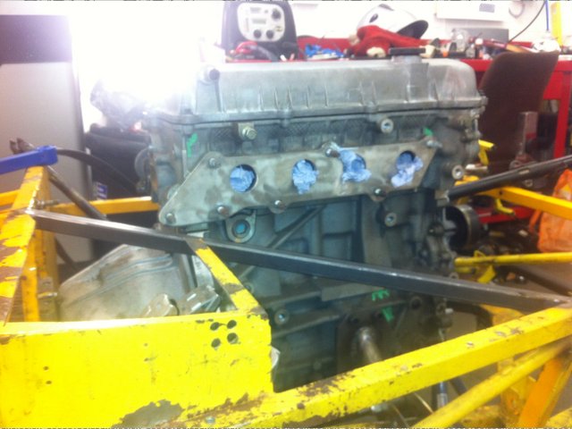

I've now done a dry-build of the engine in order to start positioning and chopping the chassis. It's going to be interesting moving this back into the tunnel as well as widening the tunnel to take the wider pedal box.
Here's the engine front-on with throttle bodies and front plate.
slightly higher up, showing the polished ally top. it also shows off how mucky the block is - I think I'll have to polish that before I complete the build.
and finally side on showing the bell-housing and scruffy block
One point of note was the throttle bodies fitting the alloy manifold - there was no way was I able to get a bolt (socked headed cap screw) into the throttle body to screw into the thread on the manifold, so I had to drill out the threads on the manifold and use lock-nuts. Not ideal, but the kind of tailoring that shouldn't put anyone off.

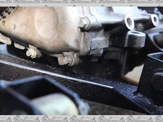

This was the problem I had.
The rail comes under the front cover bolt in the corner.
Looking at this picture:
http://www.furyrebuild.co.uk/wp-content/uploads/2012/05/tacked-with-gates-in.jpg
It seems like I would have some trouble with this sump.
The MX5 bell housing is quite wide compared to the Type 9 housing, so the engine and box can't go any further back without widening the transmission tunnel.

The sump at the moment bolts nicely to the block and whilst it aligns with the type-9 there aren't any bolt-on points. The sump isn't structural so attachment to the bellhousing isn't necessary. It can easily be strengthened to take that attachment.
It's as wide as the block and as deep as the oil-filter housing so it shouldn't make your job worse. Chopping the chassis to get the mazda bell-housing in is the concern I would think.
In my original pinto installation, I managed to get it so the back of the bellhousing was aligned with the passenger footwell and with 3mm clearance when it sat in front. It was a right challenge getting the clutch to work.
I did have to make some modifications to the chassis - when I crashed it at harewood I took the opportunity to re-seat my pinto a little lower (also meant I didn't need to modify the new bonnet to make it fit).
Here's the first change where I moved the cross member over to accomodate the clutch arm. It's a little messy now and I will tidy it up and apply triangulation from the chopped member to the new member.
When I lowered the engine and moved it a little further over make it fit in the tunnel, I then found that the alternator fouled the following cross-member, and the exhaust was also now lower which meant the steering column fouled things as well - result was to move this cross-member down. I need to tidy the welds up.
This final one shows how the sump then fouled the same cross-member I think yours did, so I moved it an inch as well. It's now the right shape.
What's also worth noting is the extra cross-bracing I put in place - the steering rack stood on pegs but with no cross-bracing which meant to me that all the steering load forces were going into the chassis by bending the pegs, so I cross-braced them (more visible on the right hand side of the photo) and the whole front which took the suspension loads was an open square shape, so I triangulated that as well. For good measure I replaced the rack bushes with stiffer ones.
The end result is that you can think the car around corners and the slightest jink on the wheel can move you 3 ft over the road - ideal for missing slippery manhole covers.
It has also meant that I need to counsel those driving it that they need BOTH HANDS ON THE WHEEL EVEN WHEN CRUSING. If they hit a brick the car would be off and they'd lose control. Also to keep thumbs in a safe place lest they get broken. After all, it's more or less a race car, not a fiesta

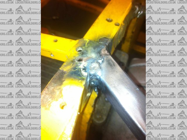

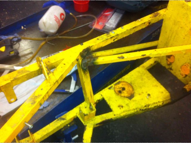

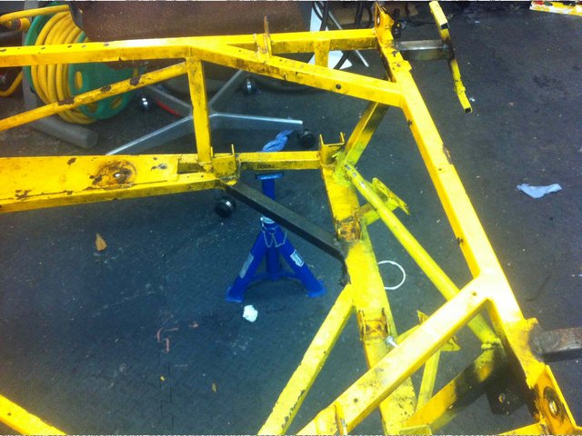

The new chassis rail is in
So, welded it in last night. It was really tricky to get all the intersecting plane angles right and to get the fitments close enough to get a good gap for tigging. Got there in the end.
This is the top-shot. The angle just 'feels' right and intersects the horizontal top of the pedal box nicely. I think I'm going to chop out all the remaining metal in the pedal box now, and go for a new enclosure. I'll keep the 1.5mm mild steel thickness of the original design. Rather than stitch 1 inch, gap 3 as the current design is, I'll stitch one, gap one. If I'm in a bad enough shunt to need the pedal box straightening, actually straightening it is the last of my worries.
Next we have the weld quality. I'm reasonably pleased bearing in mind it's not the easiest place to get to. I added extra filler around the corners because I found it had a tendency to undercut there. The scattering of holes there are for the mounting of the tub, and other things I attached straight to the chassis. They look a little random, but when you take the mounting patterns of the components into account, they make sense.
Finally, this is the view from the exhaust's perspective. there's 50mm clearance between the cross member and the bottom of the flange. There's also clearance now for the exhaust stud. If I find the exhaust is getting a little close to the steering column then I'll add a little bend into it's travel to give decent clearance.
